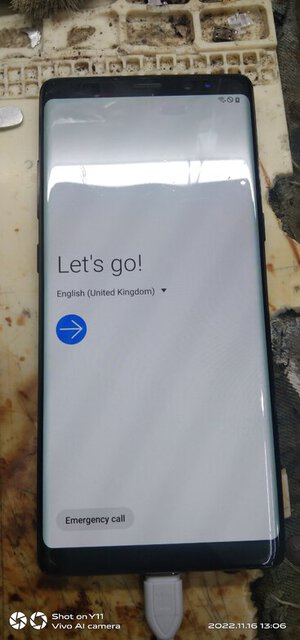

Gud am boss share ko lang po gawa ko nung nakaraan now ko lang napost Samsung Galaxy Note 8 Frp done by SamFW Tool

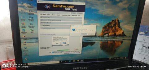

Open SamFw Tool Select TestMode
Connect phone in normal mode make sure drivers are installed

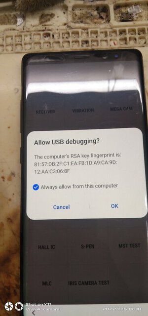

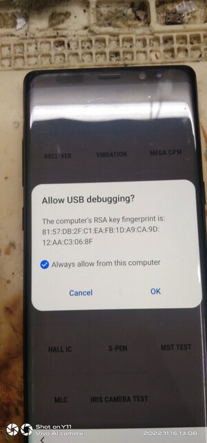

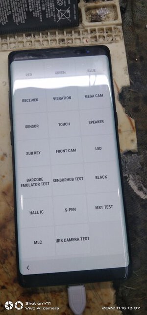

Click Remove Frp then software will promt you to put phone on testmode dial *#0*# and press ok

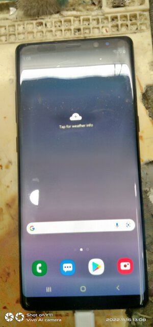

The phone will ask for usb debugging permission allow it and wait for phone to reboot manually and done... thanks
