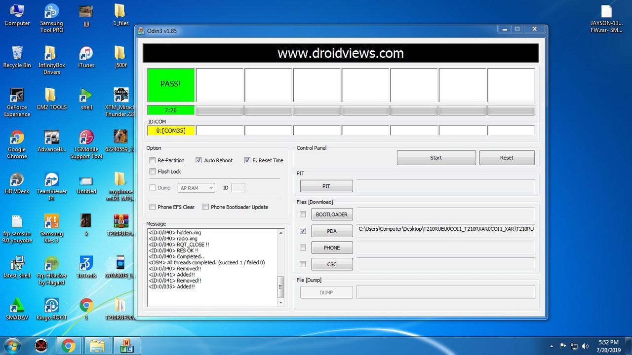

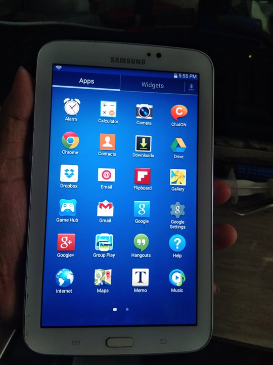

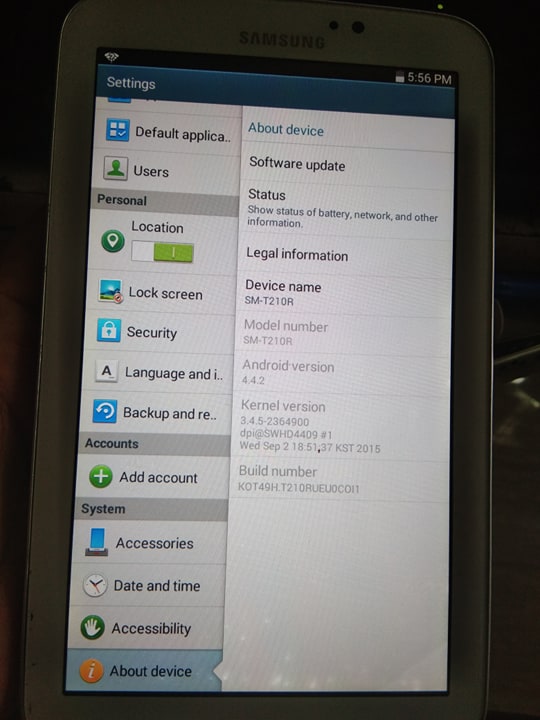

share kulang mga boss nagawa ko ngaun sm-t210R
na virus kaya hindi magamit niu tomer
1.download fw "http://www.mediafire.com/file/a5na67m58g2a11c/T210RUEU0COI1_T210RXAR0COI1_XAR.zip/file
2 open odin 1.85
3, lagay sa PDA ang download mo
4,download mode muna si tab us vl dwn
