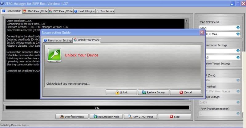

SO-01b DoCoMo (Xperia 10) unlocked via Jtag
naubusan kasi ng setool credits kaya unlock via jtag nlng
Code:
Open serial port...OK
Connecting to the RIFF Box...OK
Firmware Version: 1.28, JTAG Manager Version: 1.37
Selected Resurrector: [SE X10i]
Connecting to the dead body...OK
Detected dead body ID: 0x202400E1 - CORRECT!
Set I/O Voltage reads as 2.59V, TCK Frequency is RTCK
Adaptive Clocking RTCK Sampling is: [Sample at MAX]
Resurrection sequence started.
Establish communication with the phone...OK
Initializing internal hardware configuration...OK
Uploading resurrector data into memory...OK
Starting communication with resurrector...OK
Detected an Initialized FLASH1 Chip, ID: 0x002C/0x55B3 (1024MB)
Selected Resurrection Data for the NAND Chip with Page size = 2KB
Backup Important Zones...OK
Preparing data. Please wait...OK
Unlocking the Phone...OK
Unlock complete!
To Unlock SE X10:
Ø Solder JTAG cable to SE X10 JTAG pads;
Ø Insert USB Data cable into board and PC;
Ø Make sure SE X10 is selected in the list of models;
Ø Click Resurrect button; select unlock tab when new window appears
Ø Press unlock....Wait till software signals a successful operation completion;
Ø Disconnect power supply, de-solder JTAG wires
