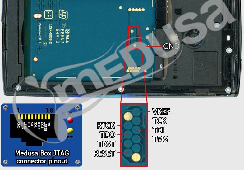

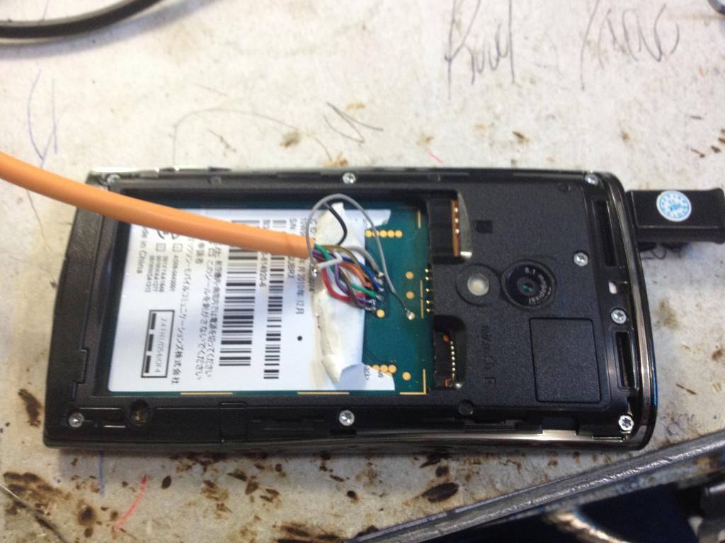

procedure: 1st soldered the pinout see the picture

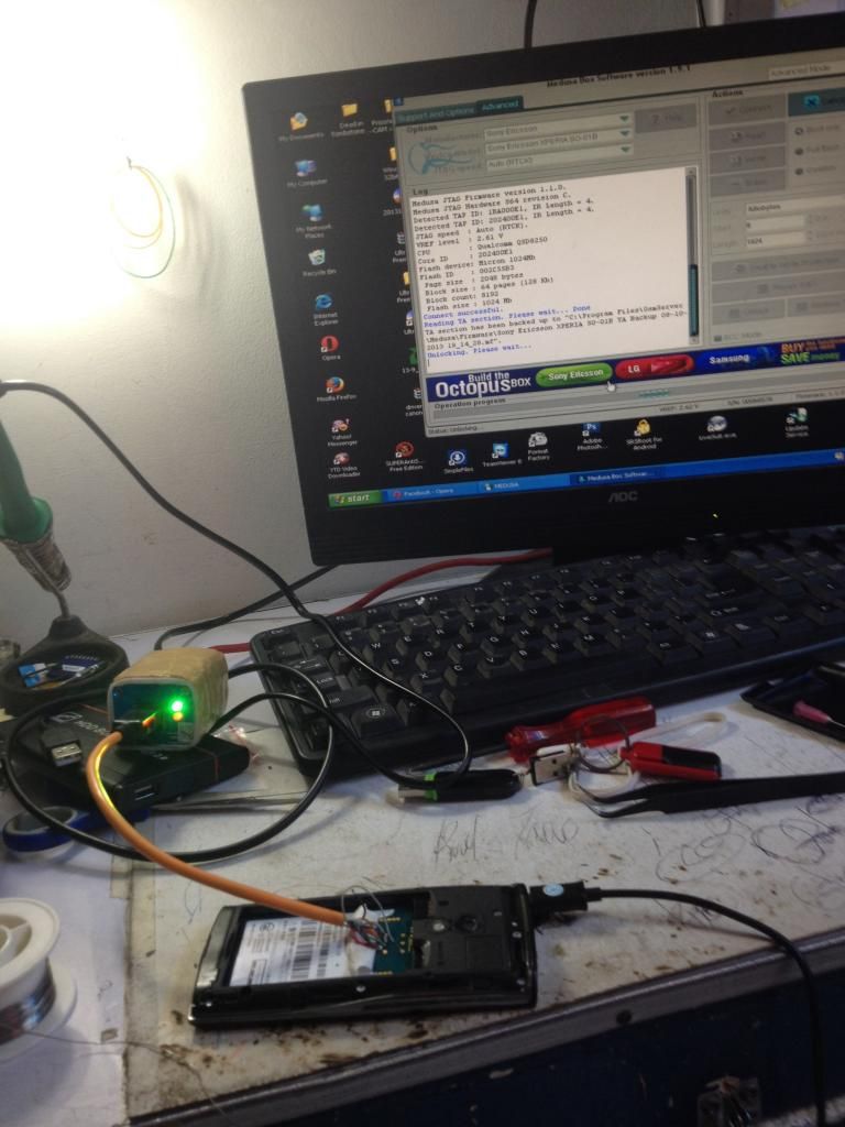

connect j-tag cable to medusa box
connect micro usb datacable on phone to pc

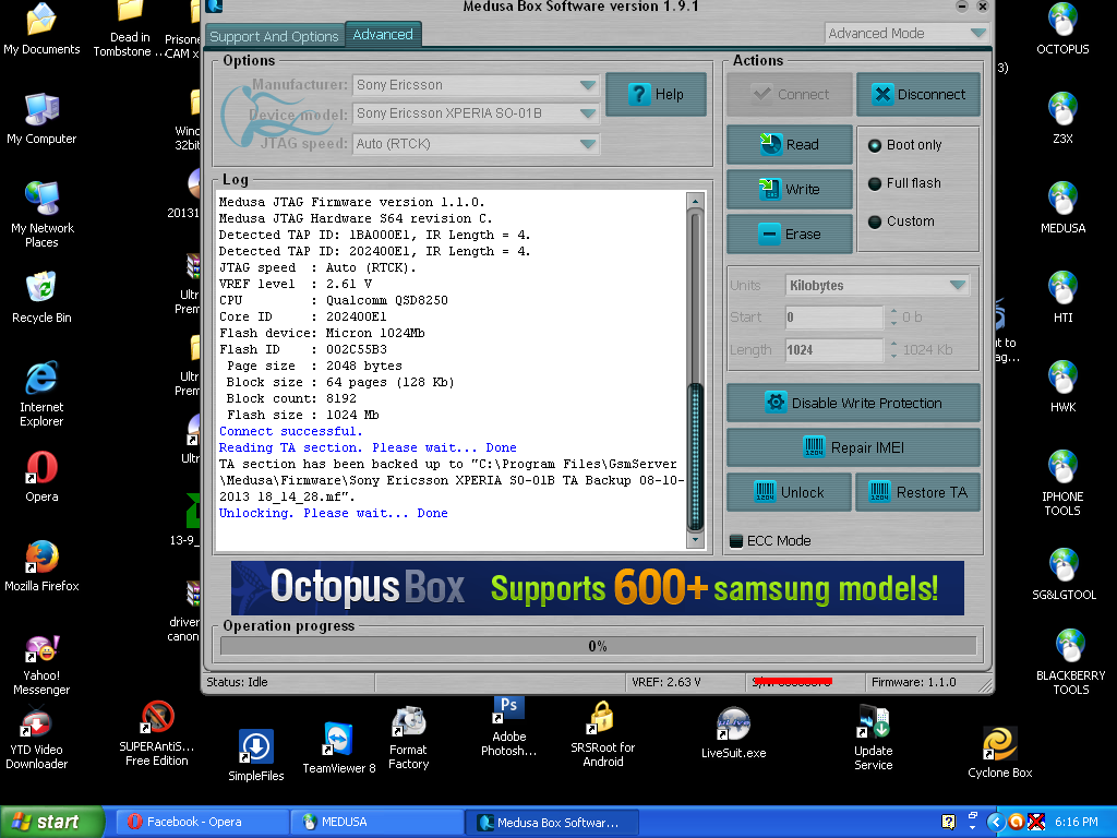

open medusa box software
select correct manufacturer
select correct model
click connect
click unlock
then wait untill finish and smile....
