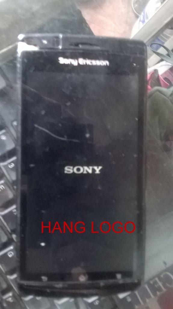

share ko lang po itong gawa ko
history
pag mag on ng bluetooth nag auto off ang unit pero ngayon Hang logo na

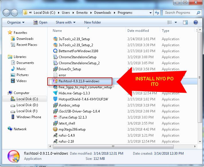

idownload ang flashtool 0.9.11.0 windows
after maidownload install nyo po

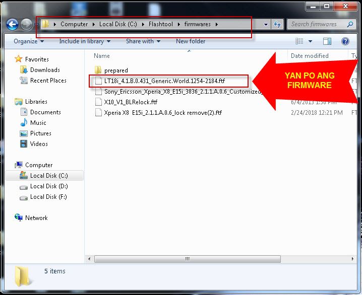

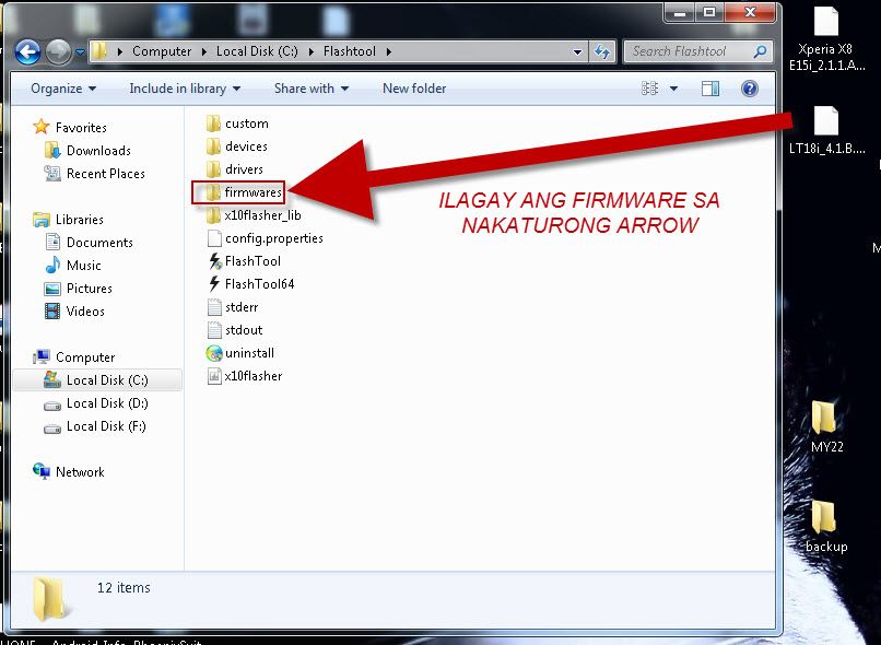

idownload din ang firmware
after madownload ilagay sa firmwares
<a href="http://s979.photobucket.com/user/adrenaline32/media/2_zpsozqsoya3.jpg.html" target="_blank"><img src="http://i979.photobucket.com/albums/ae274/adrenaline32/2_zpsozqsoya3.jpg" border="0" alt=" photo 2_zpsozqsoya3.jpg"/></a>
yan po nakapasok na ang firmware sa firmwares para pag open ang flashtools automatic nandun na

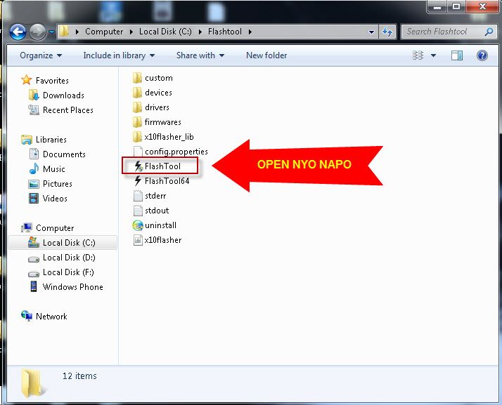

<a href="http://s979.photobucket.com/user/adrenaline32/media/3_zpsdvjqwlty.jpg.html" target="_blank"><img src="http://i979.photobucket.com/albums/ae274/adrenaline32/3_zpsdvjqwlty.jpg" border="0" alt=" photo 3_zpsdvjqwlty.jpg"/></a>
open nyo npo ang fashtool

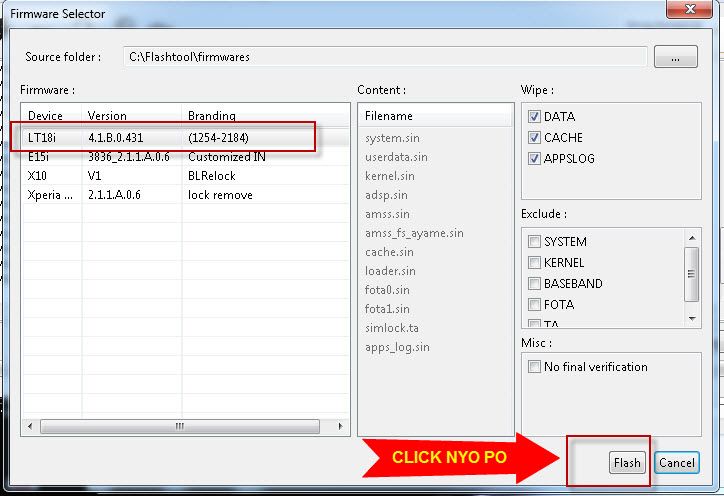

<a href="http://s979.photobucket.com/user/adrenaline32/media/4_zpszuafqwao.jpg.html" target="_blank"><img src="http://i979.photobucket.com/albums/ae274/adrenaline32/4_zpszuafqwao.jpg" border="0" alt=" photo 4_zpszuafqwao.jpg"/></a>
<a href="http://s979.photobucket.com/user/adrenaline32/media/5_zpsujgvalhk.jpg.html" target="_blank"><img src="http://i979.photobucket.com/albums/ae274/adrenaline32/5_zpsujgvalhk.jpg" border="0" alt=" photo 5_zpsujgvalhk.jpg"/></a>
<a href="http://s979.photobucket.com/user/adrenaline32/media/6_zpsecnrjdkg.jpg.html" target="_blank"><img src="http://i979.photobucket.com/albums/ae274/adrenaline32/6_zpsecnrjdkg.jpg" border="0" alt=" photo 6_zpsecnrjdkg.jpg"/></a>

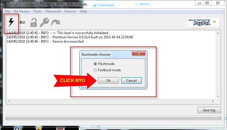

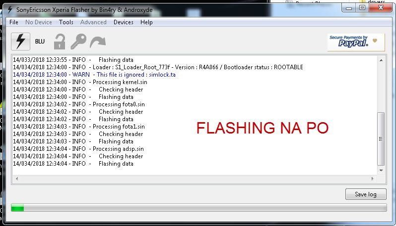

after maclick nyo ang flash
off nyo muna ang unit
hold volume down sabay salpak ng usb cable sa unit para sa madetect
ito flashing na po
<a href="http://s979.photobucket.com/user/adrenaline32/media/7_zpsjbwkgbo2.jpg.html" target="_blank"><img src="http://i979.photobucket.com/albums/ae274/adrenaline32/7_zpsjbwkgbo2.jpg" border="0" alt=" photo 7_zpsjbwkgbo2.jpg"/></a>
hintayin na matapos ang flashing

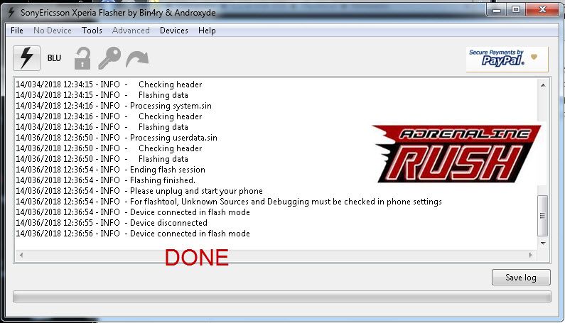

<a href="http://s979.photobucket.com/user/adrenaline32/media/8_zpsf5fehivr.jpg.html" target="_blank"><img src="http://i979.photobucket.com/albums/ae274/adrenaline32/8_zpsf5fehivr.jpg" border="0" alt=" photo 8_zpsf5fehivr.jpg"/></a>

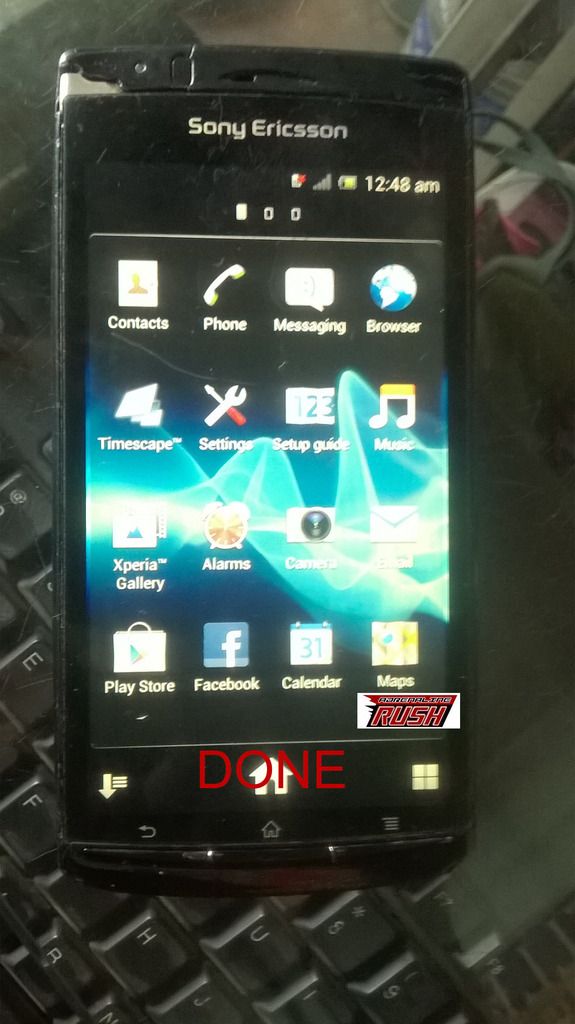

ito na po ang result
<a href="http://s979.photobucket.com/user/adrenaline32/media/WP_20180314_002_zpszfqgqvjz.jpg.html" target="_blank"><img src="http://i979.photobucket.com/albums/ae274/adrenaline32/WP_20180314_002_zpszfqgqvjz.jpg" border="0" alt=" photo WP_20180314_002_zpszfqgqvjz.jpg"/></a>
