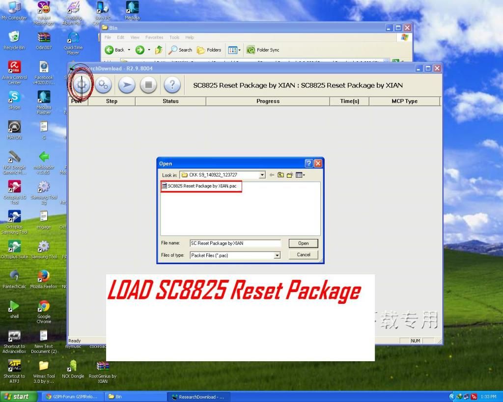

all you need is Flashtool
https://drive.google.com/file/d/0B2W5T-QQfWLfcUJRanFkLU5ZVEE/edit
and the pac file SC8825 Reset Package by XIAN
https://mega.co.nz/#!S40TSRRZ!L8mCfBku0eYKXbhr-uqo-l_S_zohU5nR2lTl2Mk5XyU

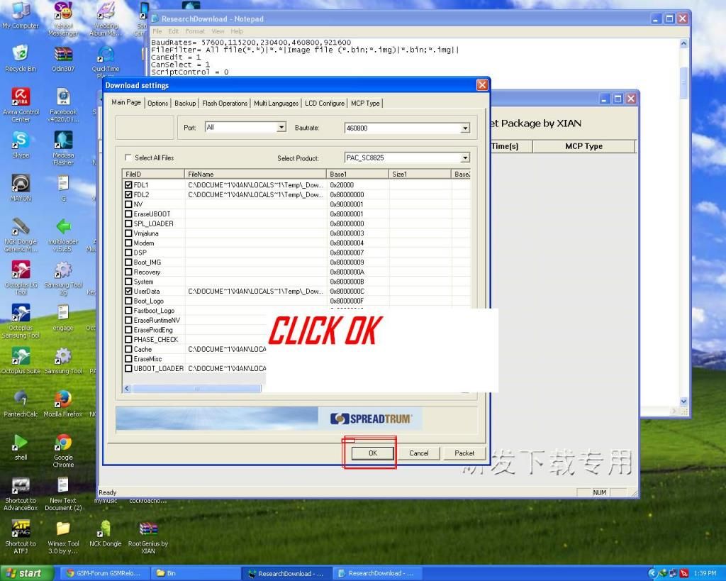

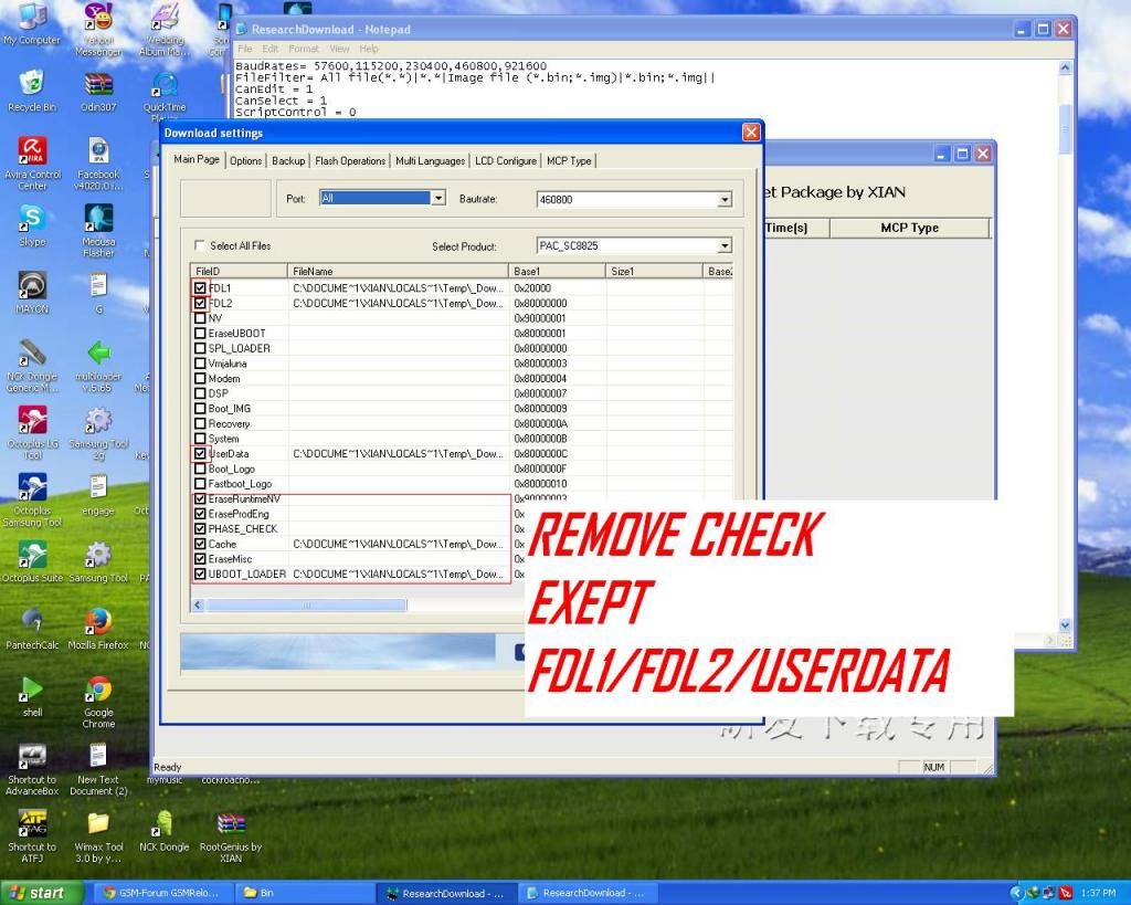

FOllow the screen shot here
remove check except fdl1/fdl2/userdata
click ok and click start
FINISH.....:-*
