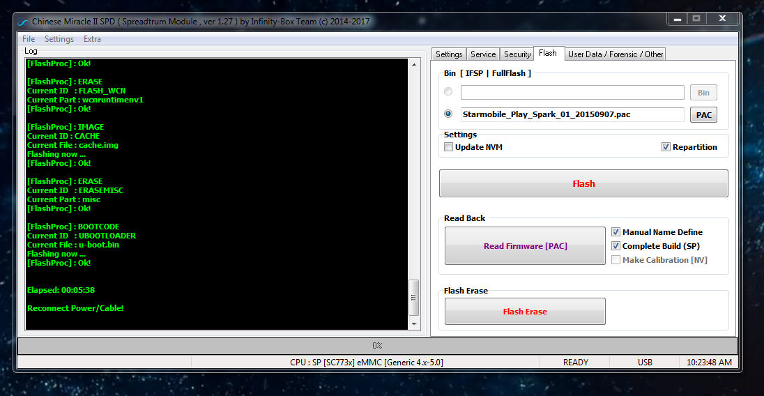

share ko lang mga boss gawa ko ngayon
ss
Code:
Card found: S/N : 28FA2B58 , v0137
Chinese Miracle II  [SPD module] v 1.27
Set mode to : SP [SC773x] eMMC [Generic 4.x-5.0]
Loading    : Starmobile_Play_Spark_01_20150907.pac
CRVersion  : BP_R1.0.0
PacCPUinfo : SC7730_UMS
PacVersion : 20150907
FastCheck  : 0x004DD360C6
Loading files ...
File : fdl1.bin
File : fdl2.bin
File : nvitem_FS046_G4B15.bin
File : wcnnvitem.bin
File : prodnv.img
File : u-boot-spl-16k.bin
File : wmodem.bin
File : wdsp.bin
File : wcnmodem.bin
File : boot.img
File : recovery.img
File : system.img
File : userdata.img
File : logo_kernel.bmp
File : logo_uboot.bmp
File : cache.img
File : u-boot.bin
File : SC7730_UMS.xml
Load Ok!
Operation : Flash [ v1.27 ]
======= Flash
Files set for flashing :
[ MCU ] : Starmobile_Play_Spark_01_20150907.pac
File : fdl1.bin
File : fdl2.bin
File : prodnv.img
File : wmodem.bin
File : wdsp.bin
File : wcnmodem.bin
File : boot.img
File : recovery.img
File : system.img
File : userdata.img
File : cache.img
File : u-boot.bin
1. Remove battery. Insert battery back
2. Press and hold 'VolumeUp' and 'VolumeDown' keys
 -> Alternative : just ONE 'VolumeUp' or 'VolumeDown' key
3. Insert cable
 ====  Wait for phone...
Phone found! [ 8 ]
Port Opened
Sync...
InitBoot Done [ 0x81 ] , Ver : SPRD3
Sync...
Sending FDL
[Info] : If SW freeze here more, than 15 seconds - remove cable
PickUp loaders from pac
FDL Ready!
Boot Ver : Spreadtrum Boot Block version 1.1
Sending FLASH FDL
FLASH FDL Ready!
Boot Ok!
FlashMode Set : Ok!
PMTManager : Load 0x17 records
PMTManager : PMT Update Ok!
Flashing now
[FlashProc] : CODE
Current ID : PRODNV
Current File : prodnv.img
Flashing now ...
[FlashProc] : Ok!
[FlashProc] : ERASE
Current ID   : ERASEUBOOT
Current Part : uboot
[FlashProc] : Ok!
[FlashProc] : BOOTCODE
Current ID   : SPLLOADER
Current File : u-boot-spl-16k.bin
Flashing now ...
[FlashProc] : Ok!
[FlashProc] : CODE
Current ID : MODEM_W
Current File : wmodem.bin
Flashing now ...
[FlashProc] : Ok!
[FlashProc] : CODE
Current ID : DSP_W
Current File : wdsp.bin
Flashing now ...
[FlashProc] : Ok!
[FlashProc] : CODE
Current ID : MODEM_WCN
Current File : wcnmodem.bin
Flashing now ...
[FlashProc] : Ok!
[FlashProc] : CODE
Current ID : BOOT
Current File : boot.img
Flashing now ...
[FlashProc] : Ok!
[FlashProc] : CODE
Current ID : RECOVERY
Current File : recovery.img
Flashing now ...
[FlashProc] : Ok!
[FlashProc] : IMAGE
Current ID : SYSTEM
Current File : system.img
Flashing now ...
[FlashProc] : Ok!
[FlashProc] : IMAGE
Current ID : USERDATA
Current File : userdata.img
Flashing now ...
[FlashProc] : Ok!
[FlashProc] : CODE
Current ID : BOOTLOGO
Current File : logo_kernel.bmp
Flashing now ...
[FlashProc] : Ok!
[FlashProc] : CODE
Current ID : FASTBOOT_LOGO
Current File : logo_uboot.bmp
Flashing now ...
[FlashProc] : Ok!
[FlashProc] : ERASE
Current ID   : FLASH
Current Part : wruntimenv1
[FlashProc] : Ok!
[FlashProc] : ERASE
Current ID   : FLASH_WCN
Current Part : wcnruntimenv1
[FlashProc] : Ok!
[FlashProc] : IMAGE
Current ID : CACHE
Current File : cache.img
Flashing now ...
[FlashProc] : Ok!
[FlashProc] : ERASE
Current ID   : ERASEMISC
Current Part : misc
[FlashProc] : Ok!
Current ID   : UBOOTLOADER
Current File : u-boot.bin
Flashing now ...
[FlashProc] : Ok!
Elapsed: 00:05:38
Reconnect Power/Cable!
link; download na
credit nalang sa uploader ng file mga boss
tested na tested,
