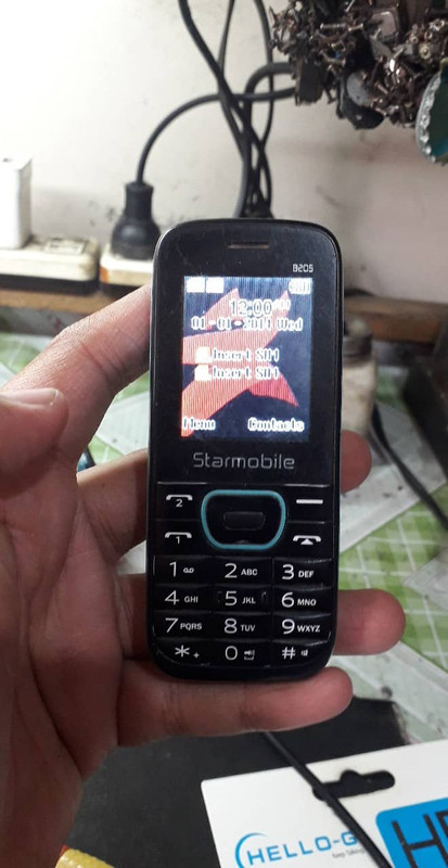

starmobile mercury b205 input password done cm2 spd
action taken

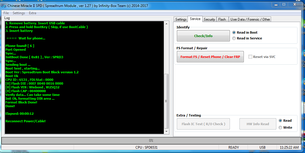

format using cm2 spd
procedure
open cm2 spd
select boot 6531
go to service
tick format
turn off phone
hold call button 1
insert usb
install driver if needed
done finish
password remove
