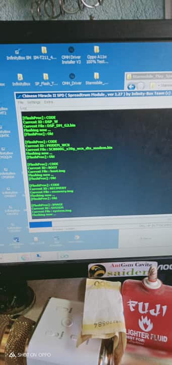

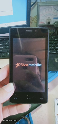

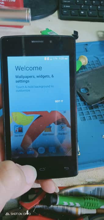

tangap ko STARMOBILE PLAY SPARK
STOCK LOGO DONE

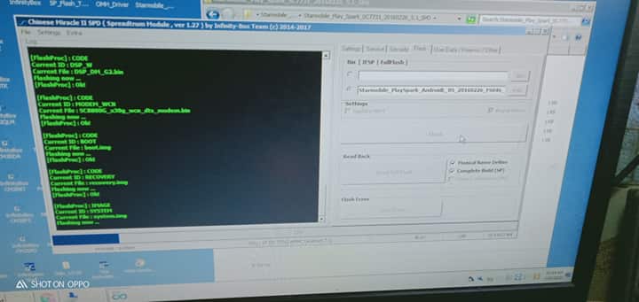

CM2SPD
ito po ung farmware/http://download1151.mediafire.com/wu82j5f5zp7g/bcd3zp0ysncbgyc/Starmobile_Play_Spark_SC7731_20160226_5.1_SPD.zip
download mulang tested po
yan
pag natapos mo
extrac mo then
open mo CM2SPD
SETTENG/SP[SC773X]eMMC[Android 7.x]
click FLASH
CLICK PAC
Then volume up
then click flash
salpak mo USB
wit munlang hangang matpos

finish product sana makatolong
