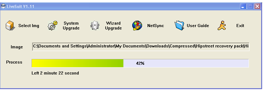

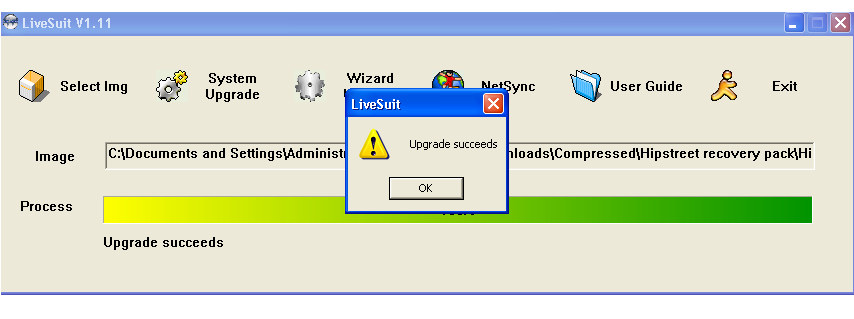

Procedure :
Open ang Livesuit
open ang firmware
then press volume up & down then insert usb cable tapos press power button 10 times
at pag nadetect na ang unit automatic mag start and upgrade
[URL=http://s1068.photobucket.com/user/Lloydz132/media/1_zpsa76d0b51.png.html]
[/URL]
[URL=http://s1068.photobucket.com/user/Lloydz132/media/2_zps3ea207d6.png.html]
[/URL]

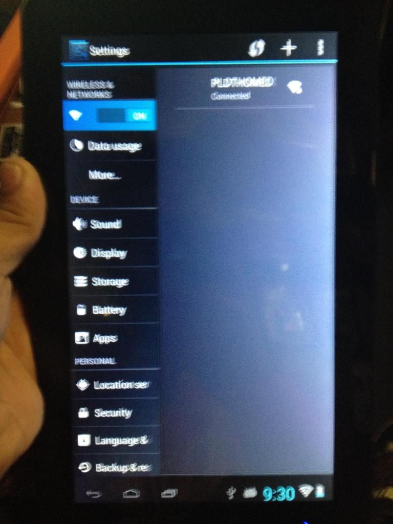

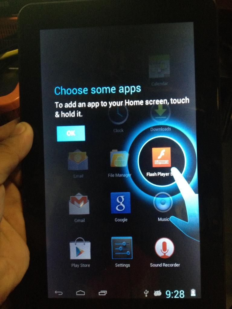

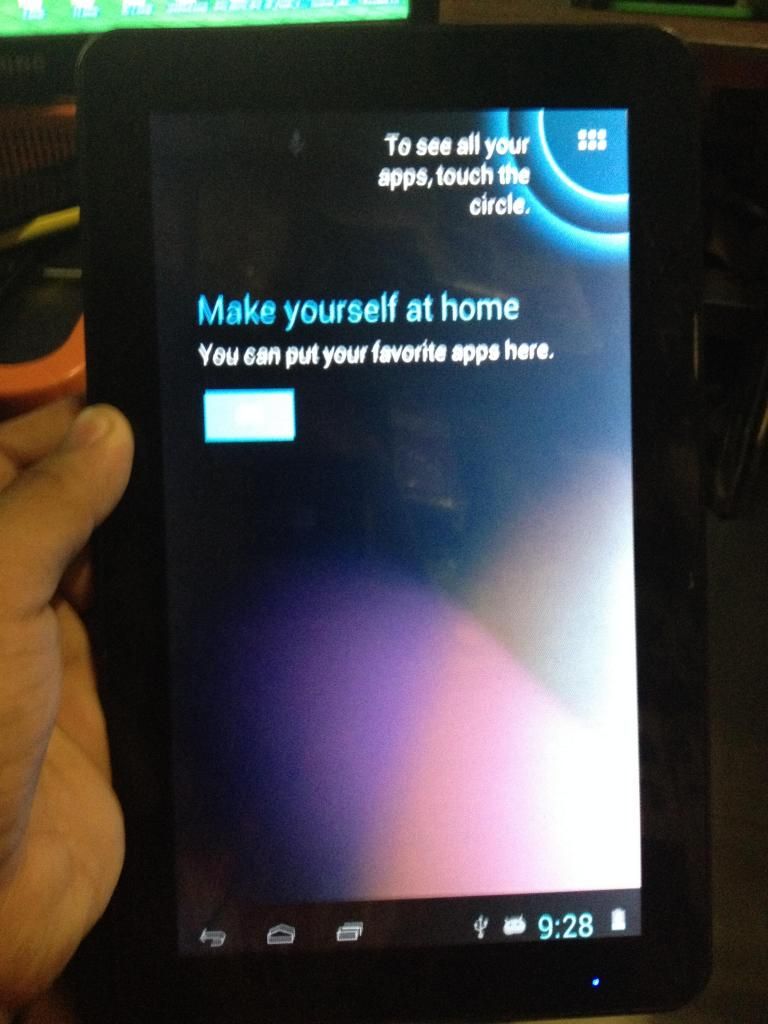

Result:
[URL=http://s1068.photobucket.com/user/Lloydz132/media/IMG_0186_zps60e70c8e.jpg.html]
[/URL]
[URL=http://s1068.photobucket.com/user/Lloydz132/media/IMG_0188_zps9ce17cbd.jpg.html]
[/URL]
[URL=http://s1068.photobucket.com/user/Lloydz132/media/IMG_0189_zpse294f279.jpg.html]
[/URL]
Working ang camera, wifi at touchscreen
