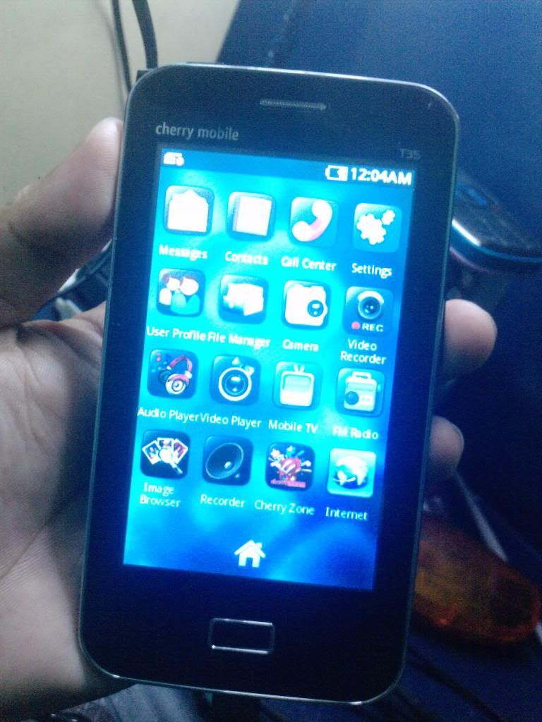

T35 CHERRY MOBILE

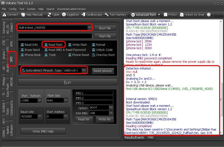

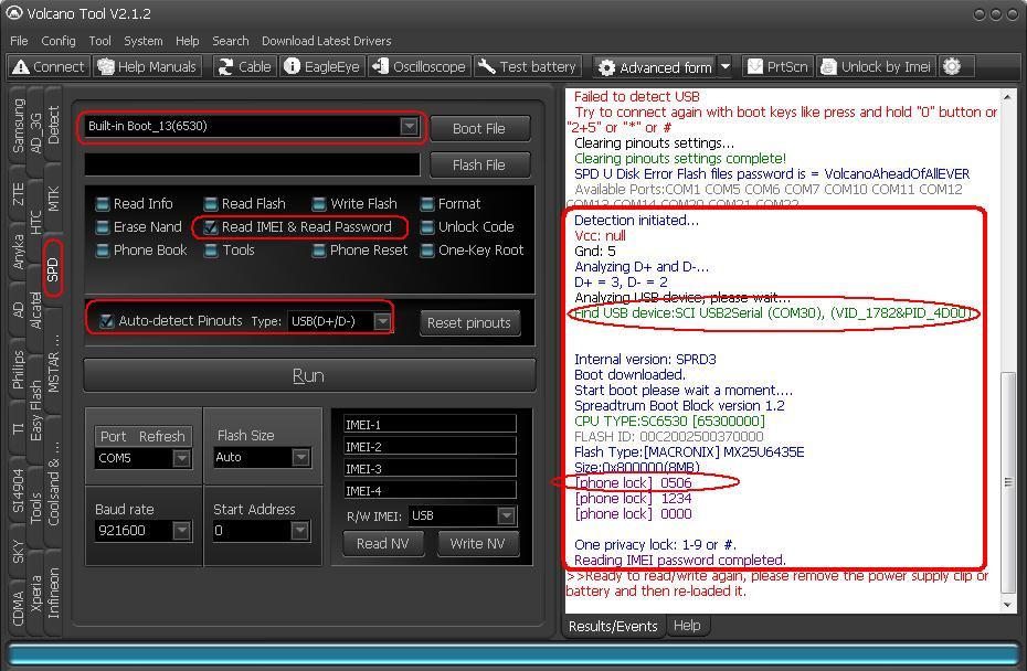

PROBLEM:
- PASSWORD/PHONE LOCK
- CPU TYPE:SC6530
TOOLS:
- VOLCANO
- P05B PIN
- MUST INSTALLED SPD USB DRIVER
HOW TO CONNECT:
PLUG IT ON BOX/CABLE, CLICK RUN (IMEI READ/PASSWORD) & HOLD HOME BUTTON​
READING
FW READ BACK UP HERE
DONE
