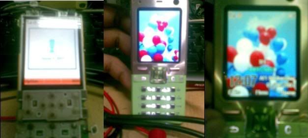

Dag-dag kaalaman lang po T650 Ericsson china phone at Pin-out.
Konting referece po sa mga bago nating mga kasamahan..lock code T650 Ericsson china walang kawala sa infiny...
COM9 [VCP6] selected
Action: read codes
unlock method: read codes
Model: Autodetect 6205-6227 NOR
Checking data, wait...
Phone should be Switched OFF !
Press and HOLD Power button now !
19200 autodetect
Initializing[6225:8A03:8A00]...
CPU: MT6225
high speed boot enabled
chip: 0001:5303:000E
Connecting, wait...
Release Power button now !
Phone detected, wait...
Hardware: MT6225,E03
Date: 2006.06.14
Version: 1.0
Version: M.RR4101002.M01002.V1.0.0.0M0808
Version: REBOUND25_06B_PMJ_HW
detecting structure #2...
0done
44 byte(s) read
imei: 44865000002927
connection Ok
detecting structure #1...
0 3 4 5 7 8warning: wrong packet cs
done
156 byte(s) read
Phone lock: On
Network lock: Off
Network subset lock: Off
Service provider lock: Off
Corporate lock: Off
IMSI lock: Off
Auto lock: Off
Phone code: 1122
Finished, time used: 10 sec

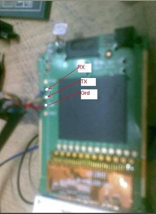

Remove/Install battery now !
Pin-out makikita sa likod ng LCD
