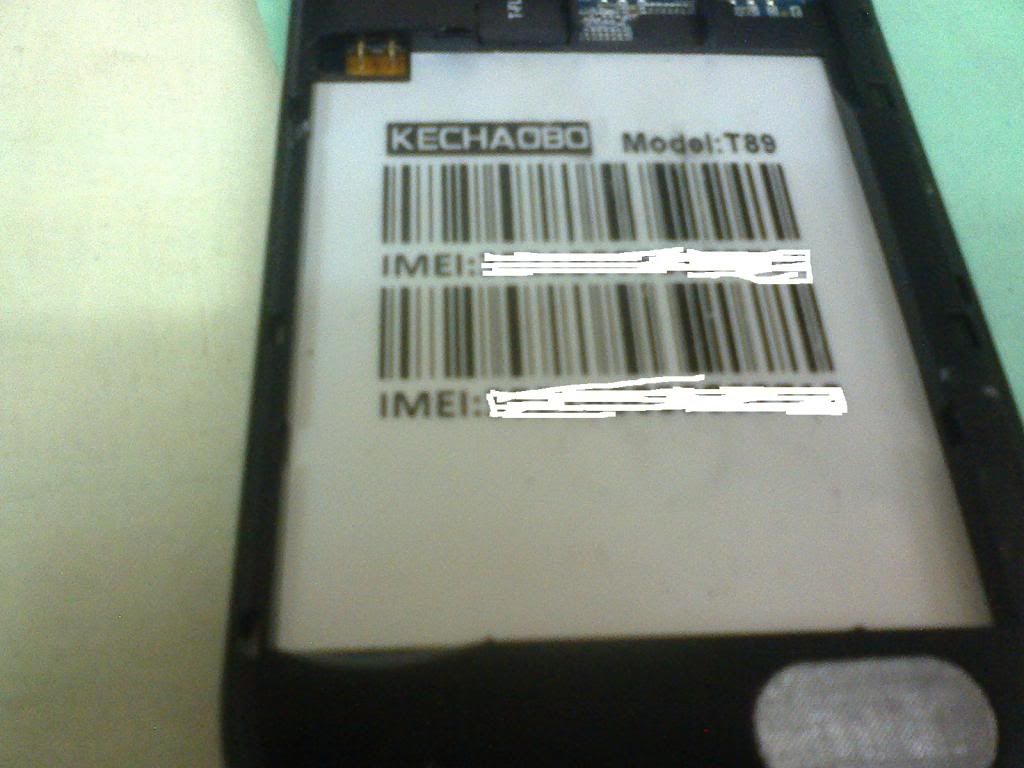

T89 (kechaobo) format done by volcano
techron
Sep 24, 2014
138
2
problem:start up hang / Hang logo
solution:format
gadget:volcano tool box

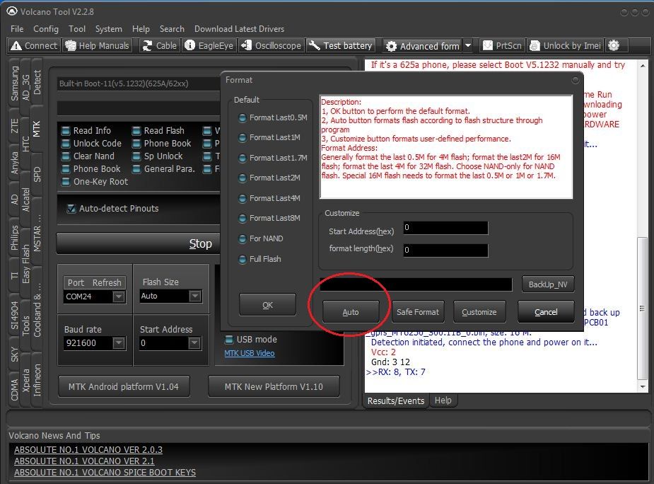

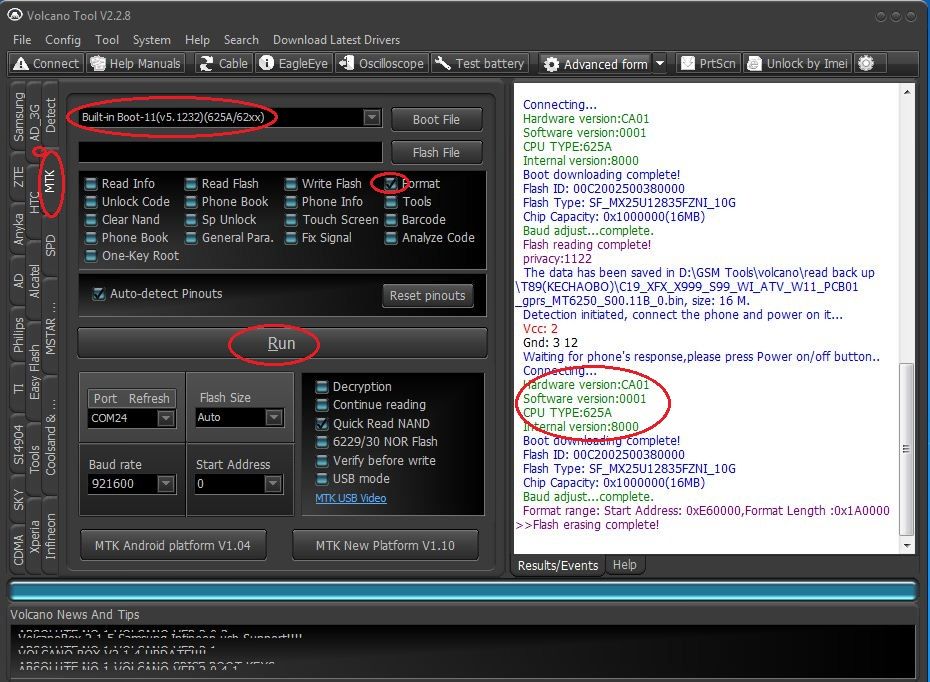

procedure:
*open volcano tool
*click MTK tab
*select built-in boot-11
*read back up first para safe
*check format
*click run
*click auto
*done
