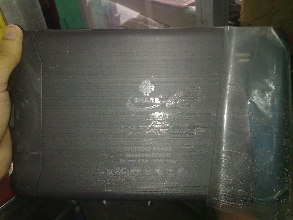

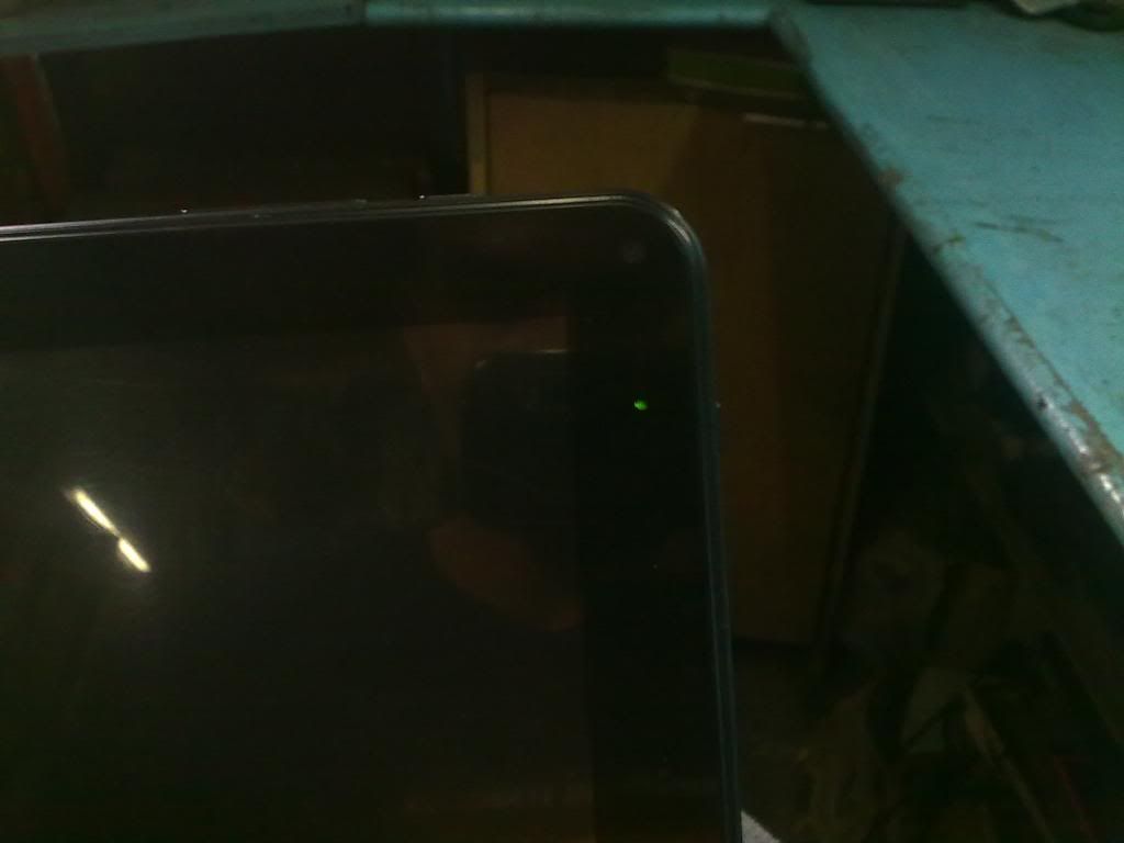

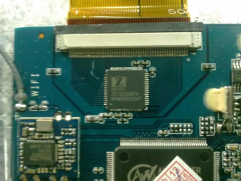

share MID 2930-II green light only

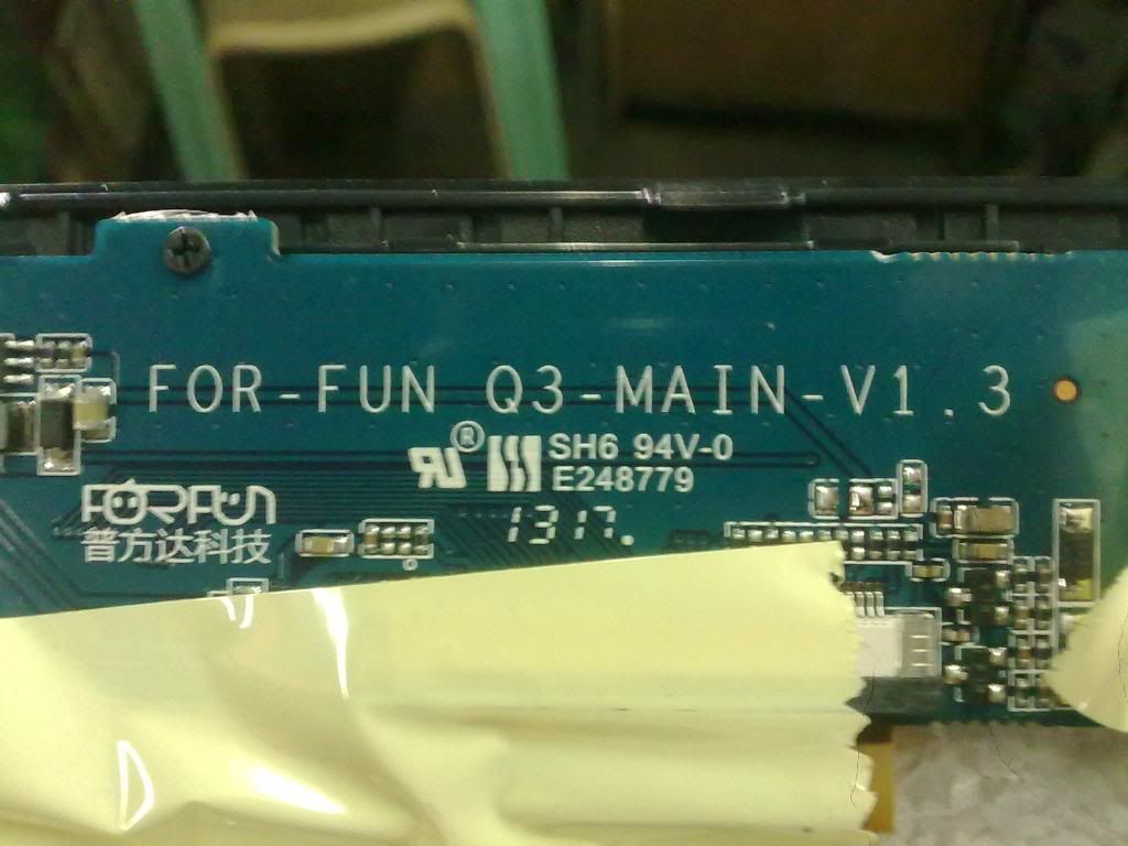

board id: for-fun q3 v1.3
touch id:zet6223

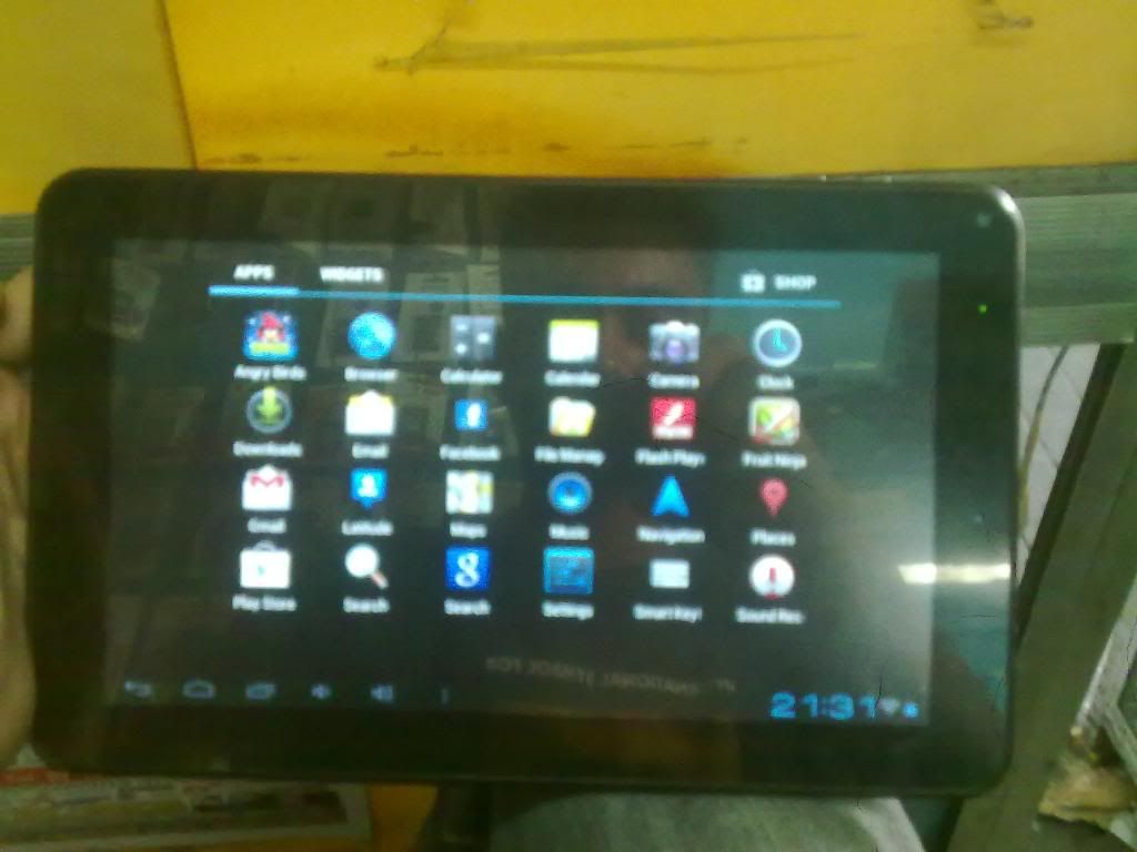

done
procedure:
1st dl this firmware:ZET6223WTAROM
livesuite livesuit 1.11 - Download - 4shared
turn off tab..
hold vol up,insert usb cable
wait till finish

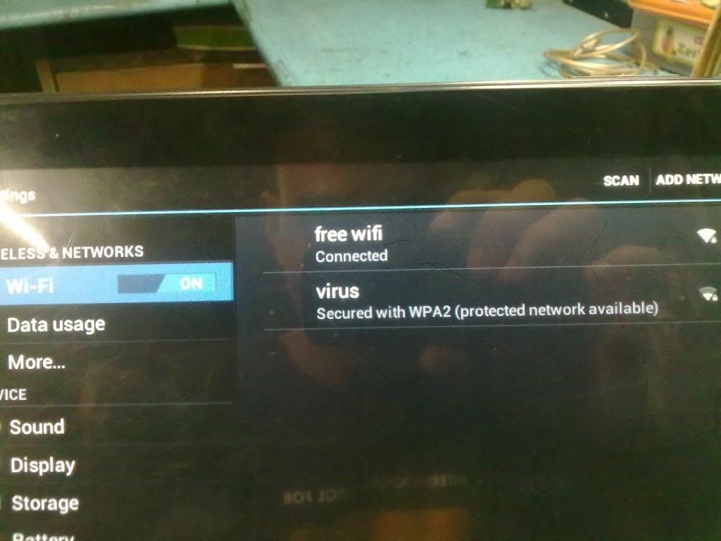

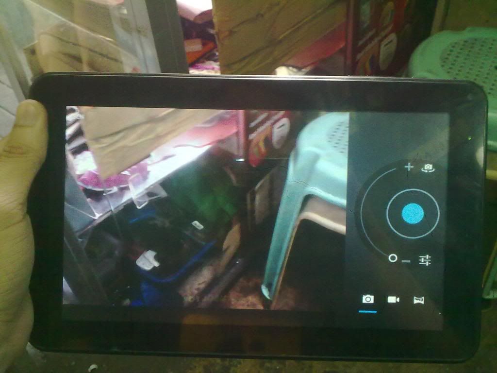

working lahat wifi.camera back&front
touch id:zet6223
done
procedure:
turn off tab..
wait till finish
