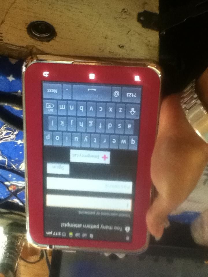

PROBLEM
Too many patterns

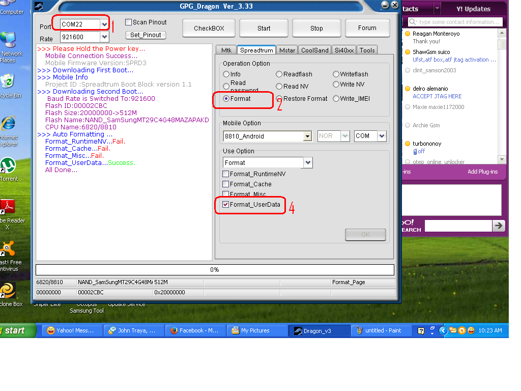

PROCEDURE.
1.Open Gpgdargon and click checkbox
2.Select spredtrum and mobile option select 6820_android
3.Select format and check format_userData
4.phone must off and press and hold vol. up and down [boot key ]
5.Install drivers needed and select correct com port..
6.Click start wait until success...
FINISH PRODUCT..
