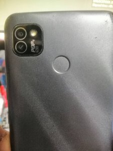

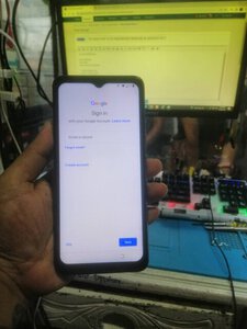

REFERENCE TECHNO POP 4 LTE PASSWORD REMOVE & GOOGLE ACC

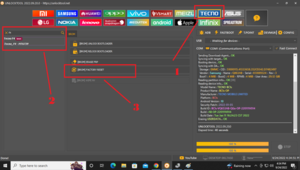

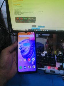

FOLLOW PROCEDURE
TOOLS NEEDED
USB CABLE
UNLOCKTOOL SOFTWARE
1. OPEN UNLOKCTOOL
2. SELECT TAB TECHNO
3. SEARCH MODEL F4
4. SELECT BROM (FACTORY RESET) KUNG NAKA HARDRESET NA PINDOT MO ERASE FRP
5. BOOTKEY VOL UP & DOWN
6. SALPAK USB DONE
