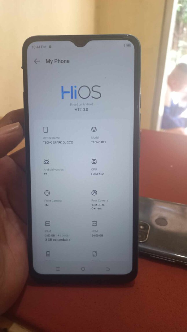

Model: TECNO BF7
Issue: Google Account/FRP

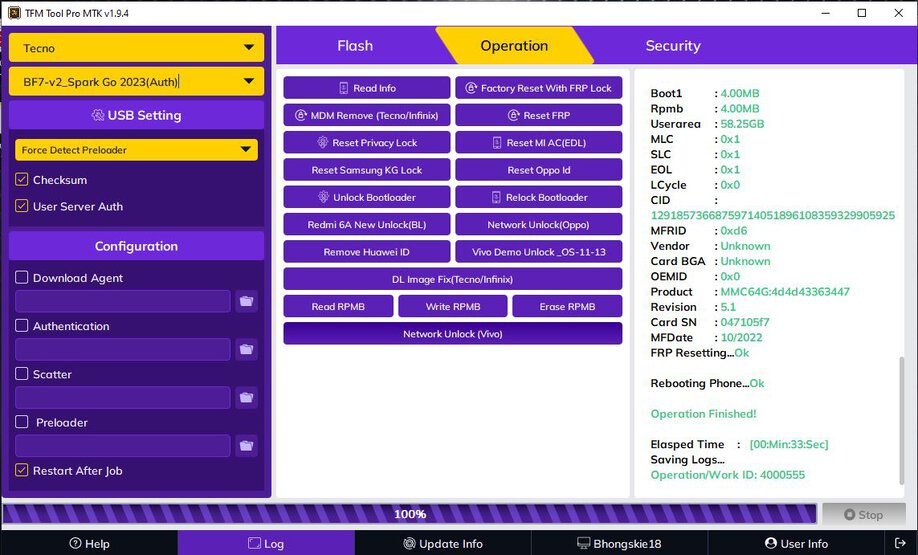

PROCEDURE:
- TFM Tool Pro MTK
-Select Brand (Tecno)
-Model (BF7-v2_Spark Go 2023(Auth)
USB SETTING:
-Check (Checksum)
-Check (User Server Auth)
OPERATION:
-Click Reset FRP
-No Bootkey
-Insert cable

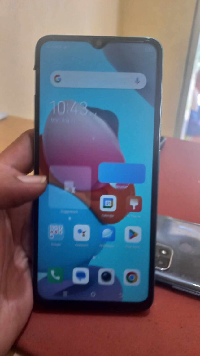

-Wait & Done
384517329_137814199414172_7291180183809704213_n.jpg384513310_1075270677181408_3927132547642679432_n.jpg
