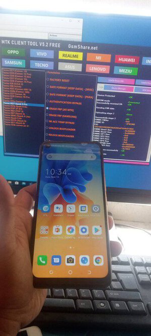

dinala ni costumer nalimutan password.kaya
first step hardreset ko muna press Volume UP And power button..
after format may google account.
para sa remove google account.
open MTK CLIENT TOOL V5.2
CLICK MODEL;KD7 SPARK 5 PRO
SELECT;ERASE FRP(ALL MTK)DIN START
HOLD V+V- SALPAK USB.wait nyo lang mag formatting ok.sana makatulong mga boss
