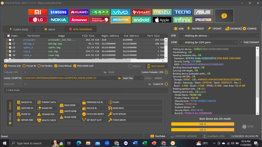

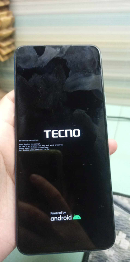

Tecno Neo Pova LE6 MT6765
Issue: DM-Verity Corruption
Procedure:
Open UT, Select MTK Tab.
1. Click Preloader Auth and select - Infinix Tecno Itel.

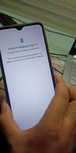

2. Ginawa ko itong tatlong process na nasa baba nawala yung issue pero sa setup data at wifi error.
  • PERM/UNLOCK BL
  • FORMAT DATA
  • PATCH DM-VERIFY
4. Nag decide ako na e flash ko ng stock room kaya nag hanap ako ng firmware Sa UT parin ako nag flash.
Ito gamit ko na firmware:
https://www.mediafire.com/file/j9m8...-GL-221028V747%28MobiFirmware.com%29.zip/file

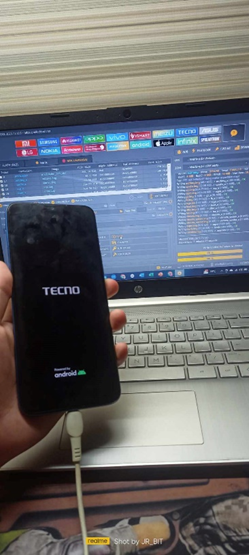

success naman pag ka flashing kaso boot loop sa logo.
5. Try ko format data ulit sa UT under MTk tab parin.

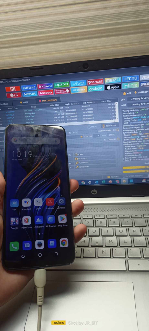

6. Nag success narin sya at set up na.
Procedure:
  • PERM/UNLOCK BL
  • FORMAT DATA
  • PATCH DM-VERIFY
https://www.mediafire.com/file/j9m8md61shk5n2u/LE6-H6222CDEFG-R-GL-221028V747%28MobiFirmware.com%29.zip/file
