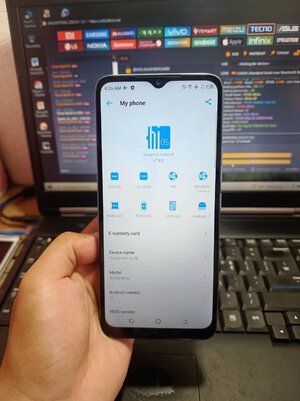

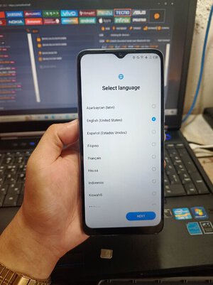

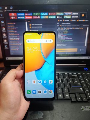

PROCEDURE:
1. Open UNLOCKTOOL
2. Select Tecno tab
3. Select SPARK GO 2021 MT6761 (brom)
4. (BROM) Erase FRP
5. Power off unit
6. Hold volume up and volume down button
7. Insert usb type cable
8. Wait until done
