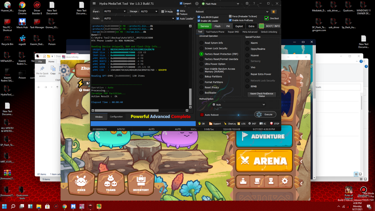

procedure:
FOR PASS: off unit, click power button in 2second tapos VOL UP..pag andar bitawan muna ang power then hold POWER until recovery..
FOR FRP: open MTK MODULE ng hydra.. click ULTRA POWER OPTION then EXECUTE.. off mo unit bootkey VOL+/- at salpak muna.. antayn matapos..
DONE.. SALAMAT
