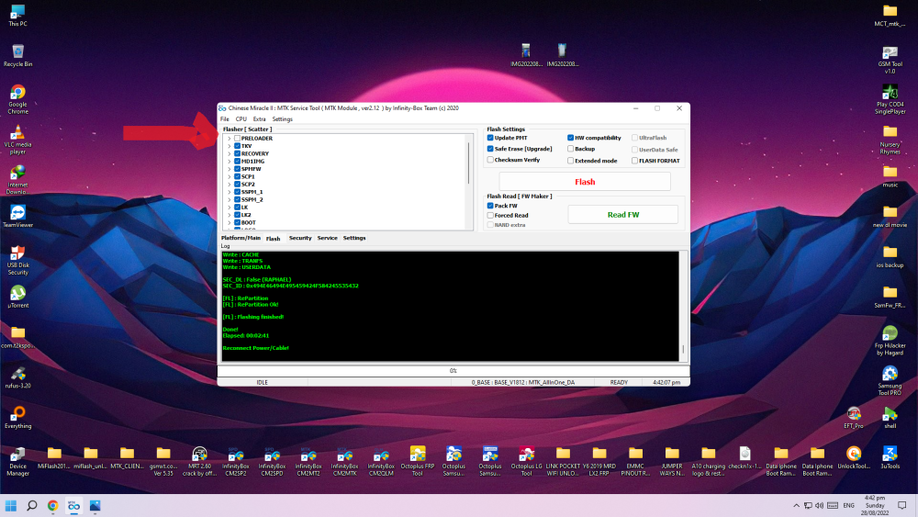

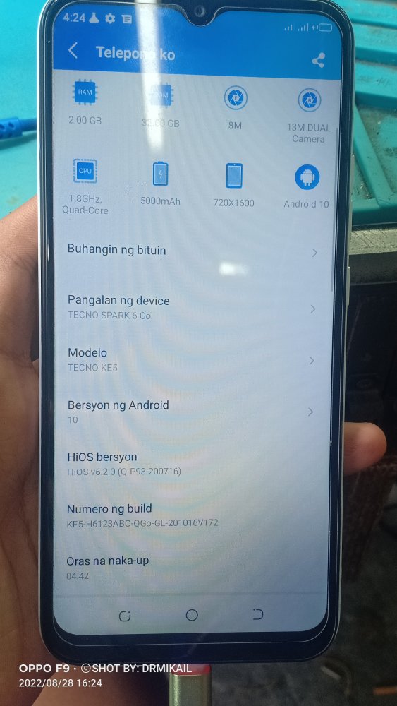

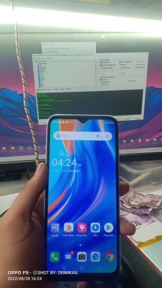

History:Nalowbat habang naguupdate then error na lumalabas hanap firmware then flash
Action Taken:first download po ang firmware ito yung link FIRMWARE then open cm2mt2 version 2.06 select base 1802 then iuncheck yung preloader press volume up & down para sa pagconnect hintayin matapos then power on at iset up credits sa may ari ng firmware :)
