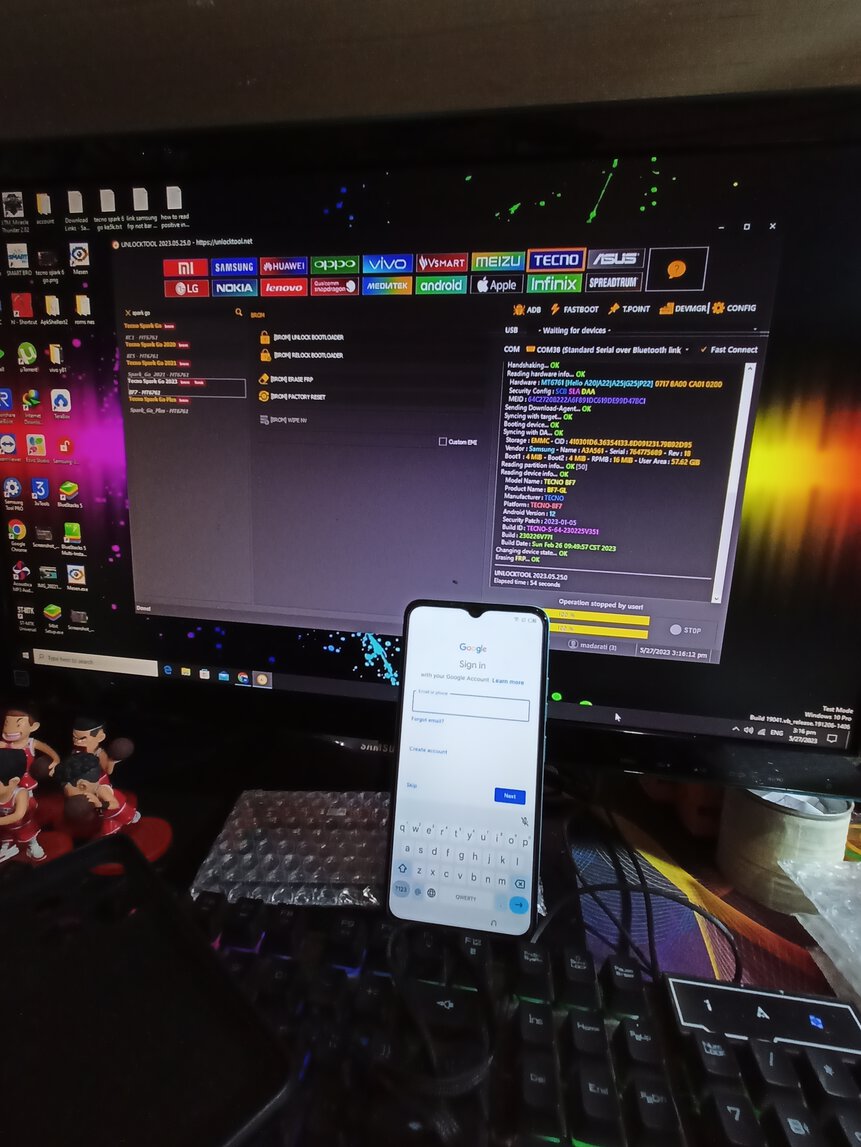

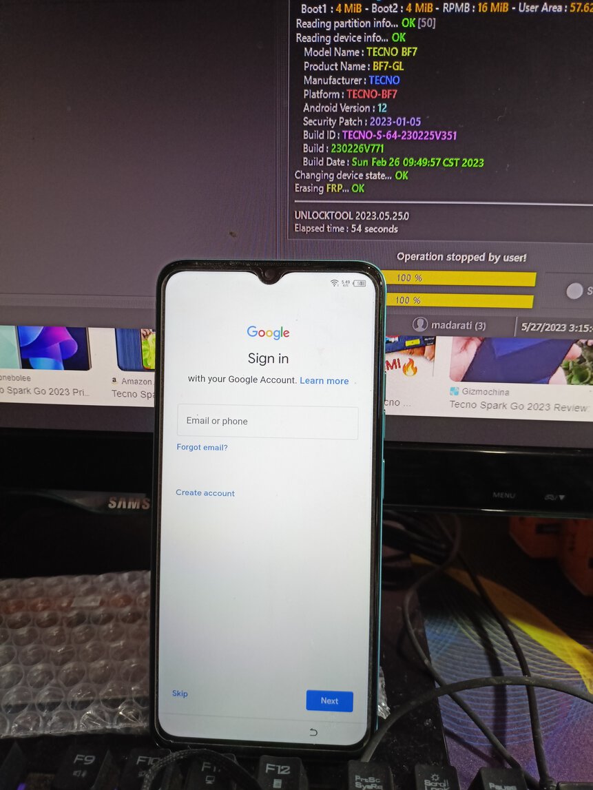

open unlocktool
select tecno
select model: tecno spark go 2023 brom force
select brom erase frp
press volume up and down button
insert usb cable
(pag nagcharge ang cp at nag waiting for device unplug lang usb cable at press volume down and up at insert ulit usb cable)
