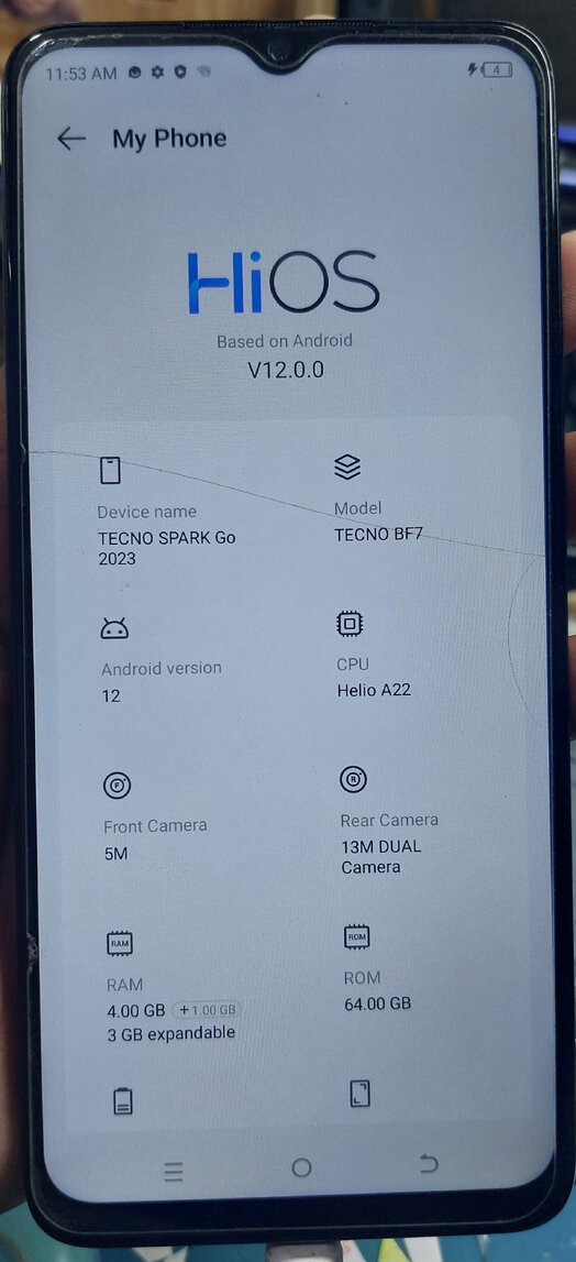

History: Pag open ng unit may lumalabas na "dm verify error". Na try ko sa UnlockTool patch dm at format ganun pa din kaya nag decide ako humanap ng fw. Bali tatlong beses po ako nag flash sa iba't ibang fw. Sa 1st fw ganun pa din. Sa 2nd fw ganun pa din pero nag iba yung error "dl image fail". Sa 3rd fw dun na po nag success :)

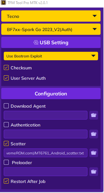

2. Open TFM Tool Pro MTK

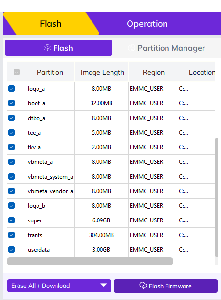

3. Paki sundan po nakalagay sa pic

4. Insert firmware at pakisundan din po ng pic

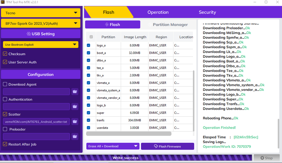

5. Select Erase All + Download
6. Turn off phone
7. Press Volume Up + Volume Down together. Click Flash Firmware. Then connect usb.
8. Then wait til finish...
9. Done.....

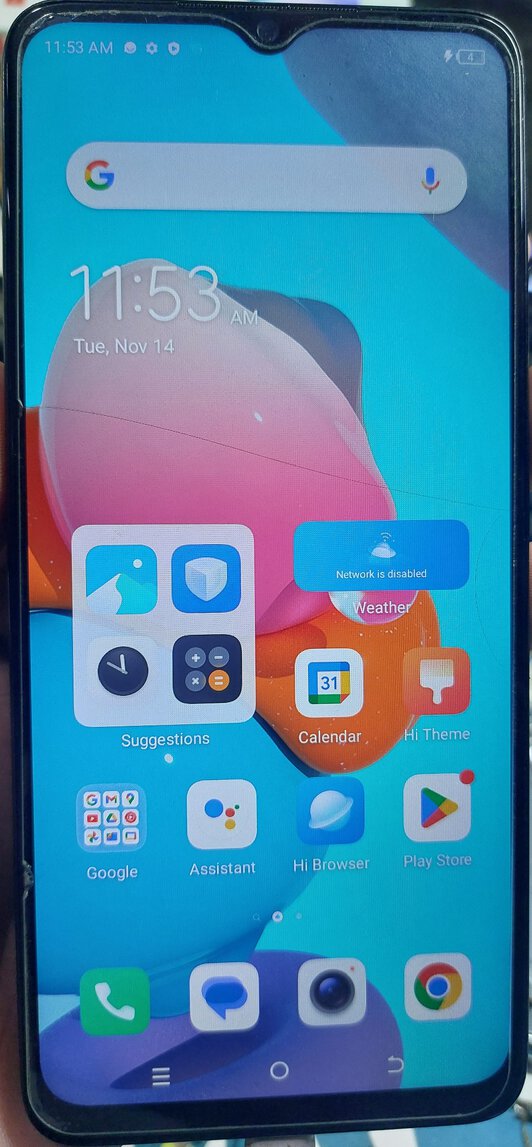

Finish Product:
