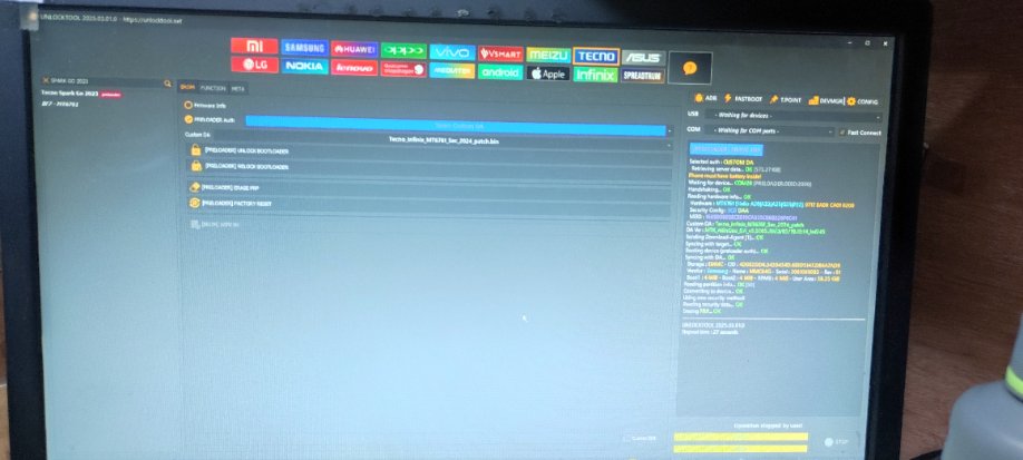

open unlocktool
tecno tab
search TECNO SPARK GO 2023
brom tab
check preloader
techno custom DA
tecno_infinix_MT6761_sec_2024_patch.bin
erase frp
nakaon ung unit salpak usb
tapos off u lng
auto detect na yan no boot key
done na po yan
my screen shot para mas madali masundan
open unlocktool
tecno tab
brom tab
check preloader
techno custom DA
erase frp
tapos off u lng
done na po yan
kng ayaw madetect off unit tpaos hold vol -+ then insert usb cable

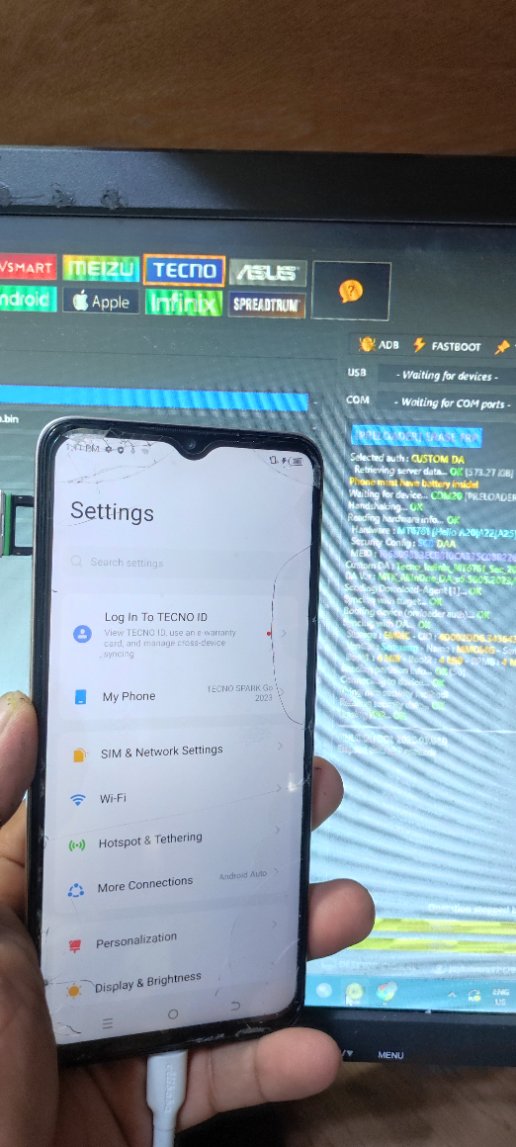

Thank you tested saakin boss salamat sa pagbahagi mo .. tested 101%
