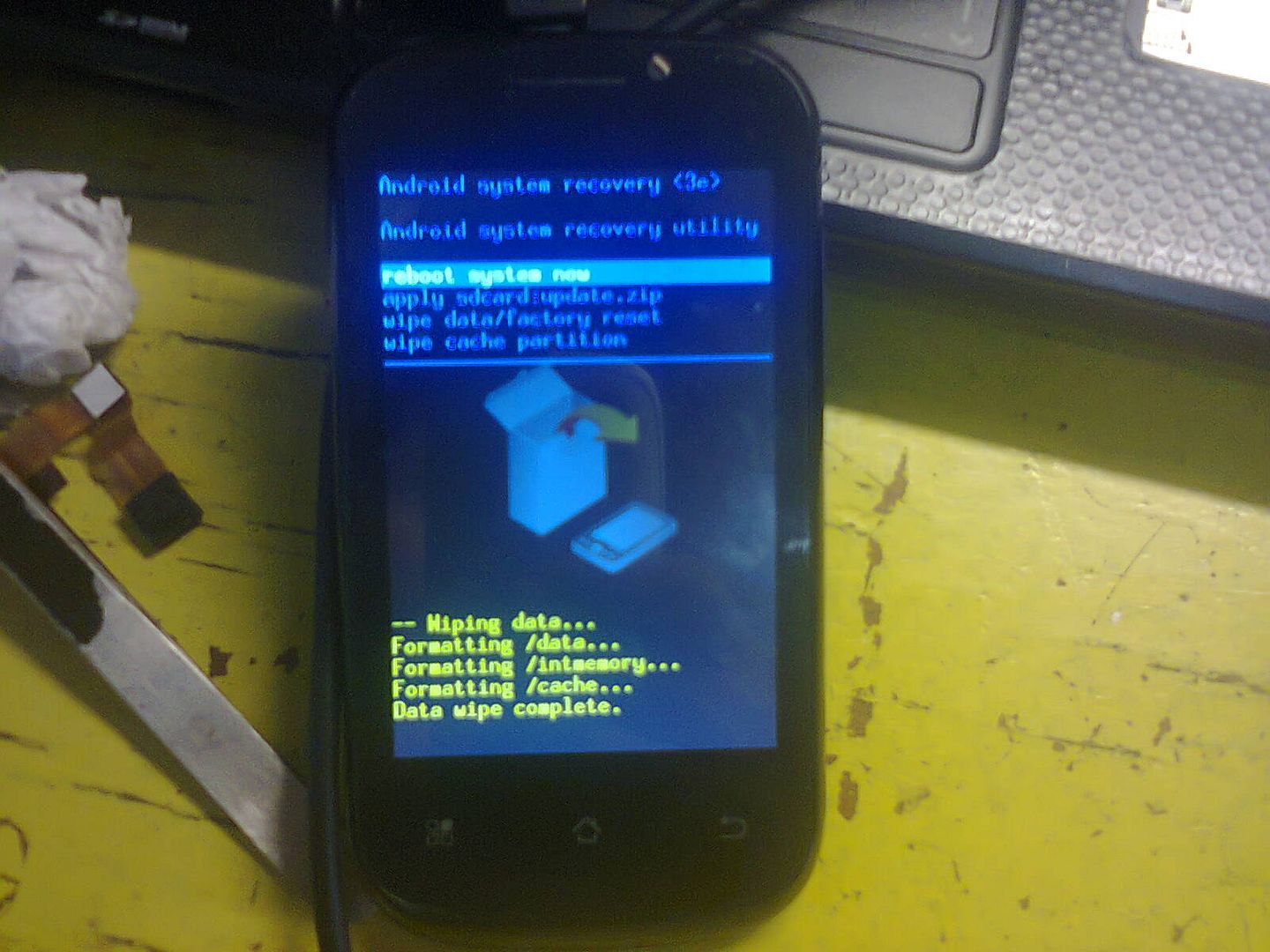

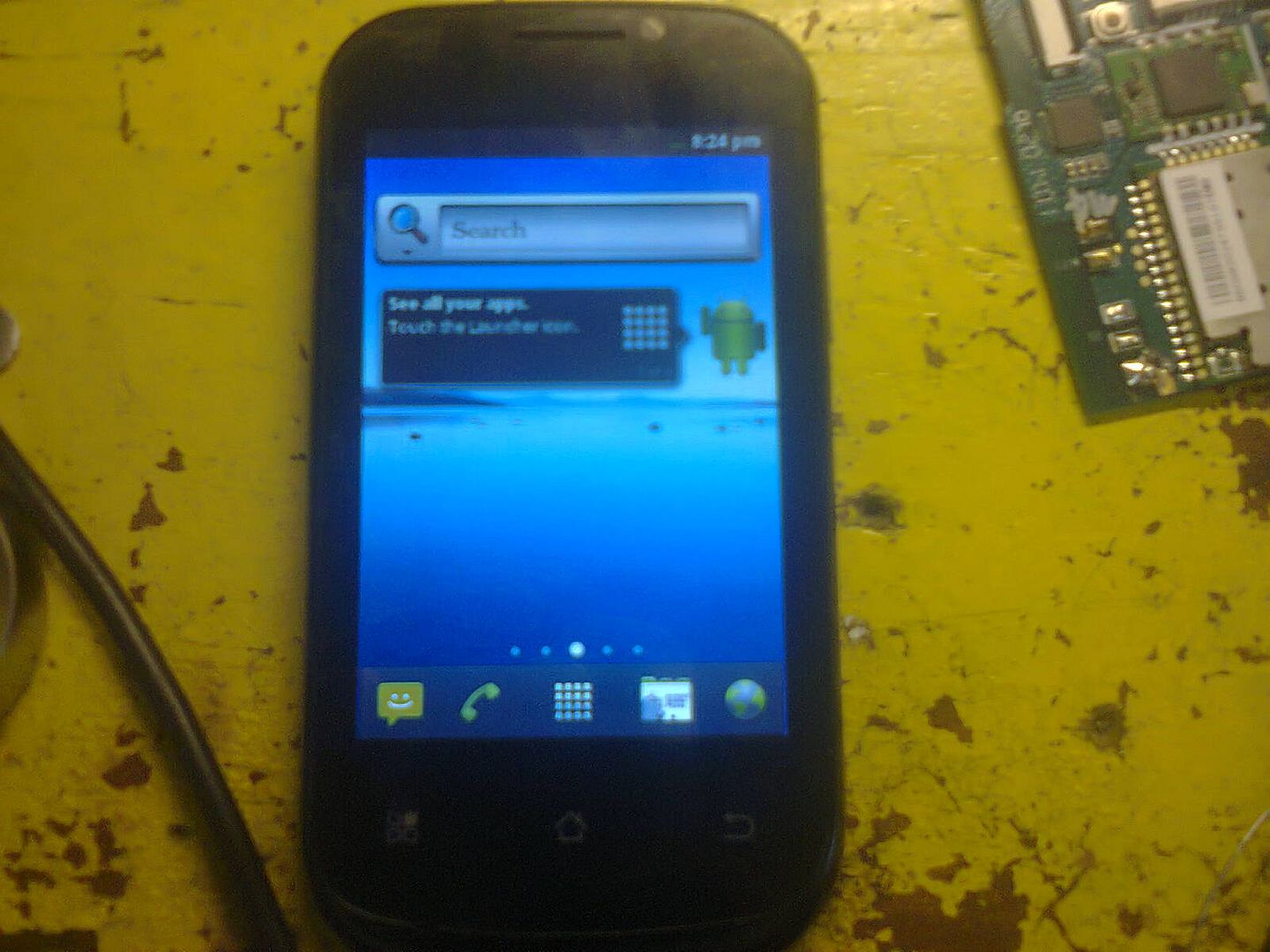

telego g303 hard reset...
for tmpa, pattern lock, hang unit.
Long press power button and volume down....
wait for system recovery.
press volume down twice..
press power switch button for select..
wipe data/factory reset.
press volume down seven times...
press power switch select ...
delete user data.
press power switch..
reboot system now.

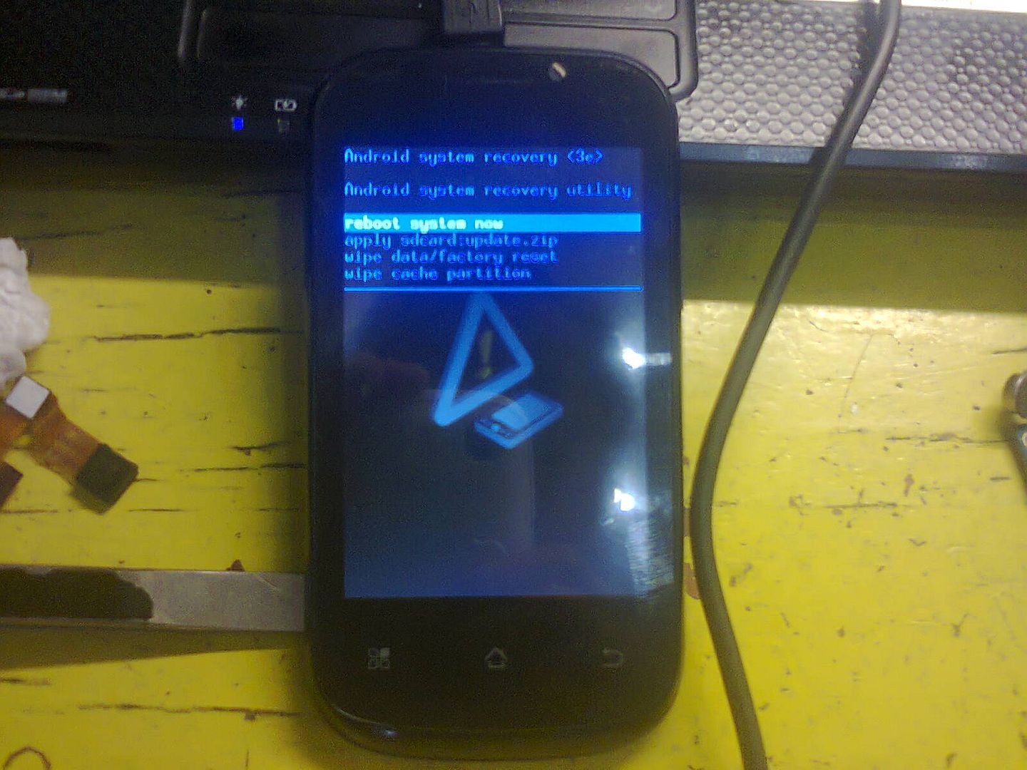

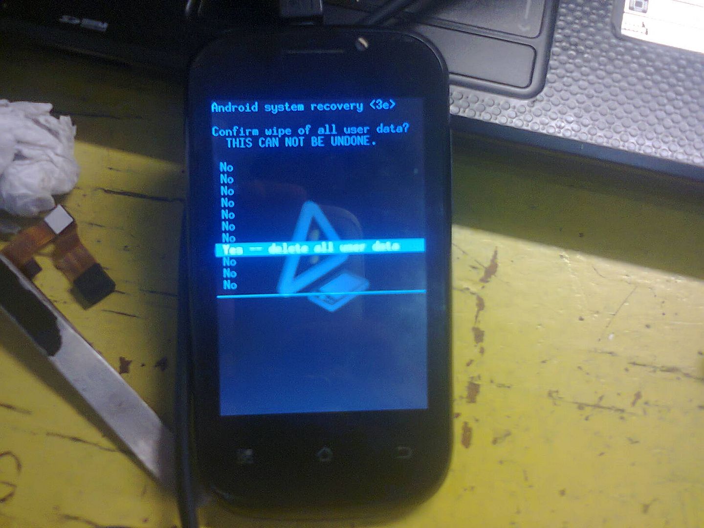

delete user data.

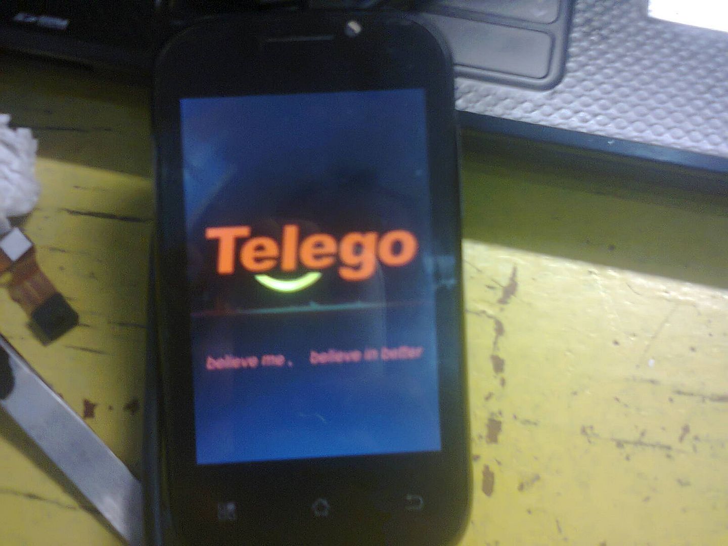

reboot system now.
