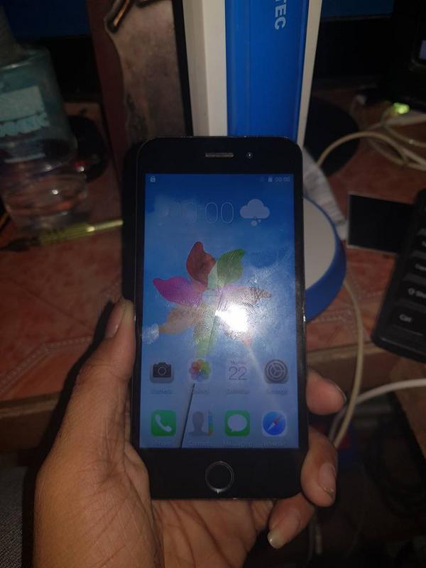

ModeL:Telego Spot

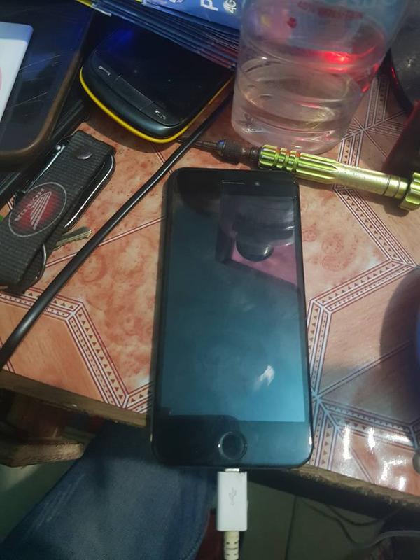

Ginagamit daw bigLa namatay try ko saksak sa PC ko nadedetect pa nmn

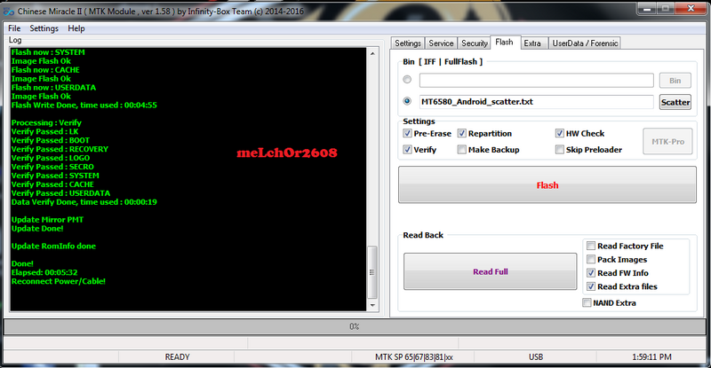

kya try ko sa Flashing naghanp ako ng Firmware dito sa bahay ntn at may nakita ako
ito---http://www.antgsm.com/showthread.php?t=113922&highlight=telego+spot
yan buhay na po may ilaw na ung 450 kita...:)):)):))

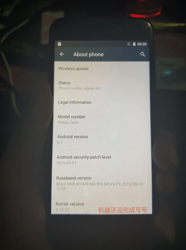

yan po ung extact model at version ng phone
490e2f8c
salamat po sa original uploader ng
firmware muLi salamat
Firmware---https://www.4shared.com/rar/LaFY3vhGce/MT6580__Telego_Spot__Telego_Sp.html
