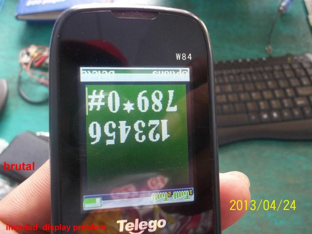

REFERENCE telego W84 reverse to position display(inverted) done by dragonbox..

Model; Telego W84
Problem; inverted display

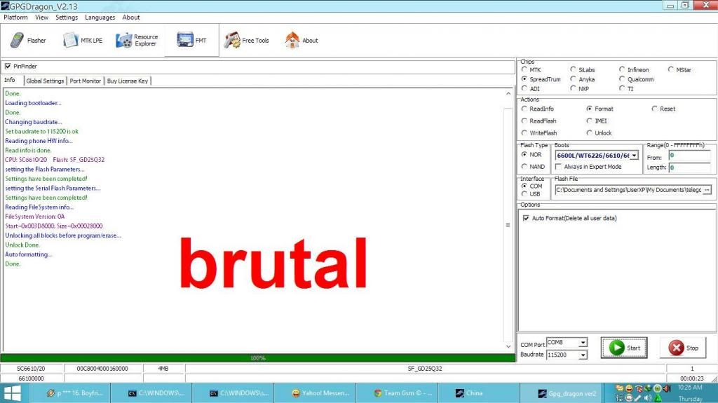

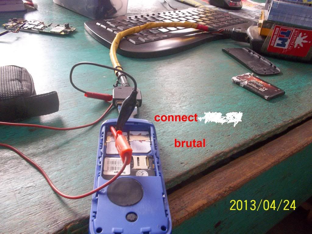

Tools; dragonbox
connect the phone to usb going to box..
open shell ver.2.13 and click connect,
select spreadrum
1st-back up first
select readflash
2nd-select format

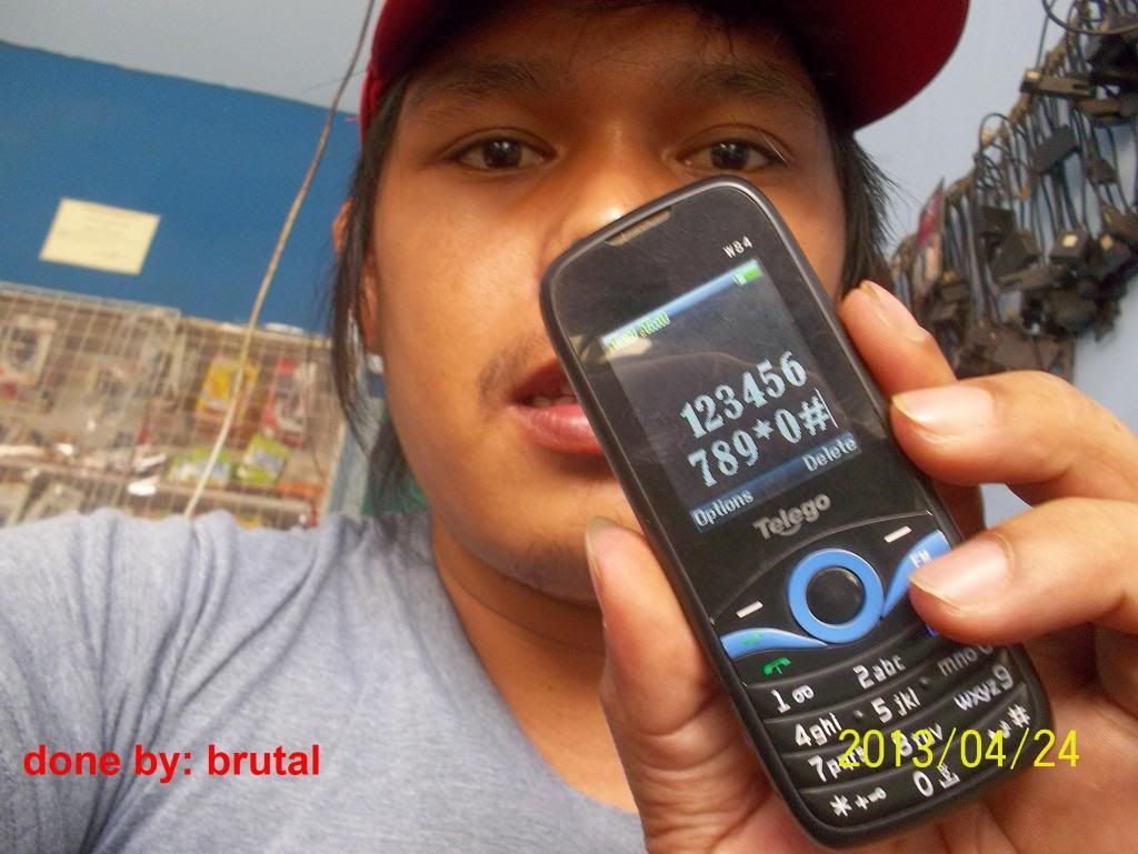

done format and testing..
finish product
