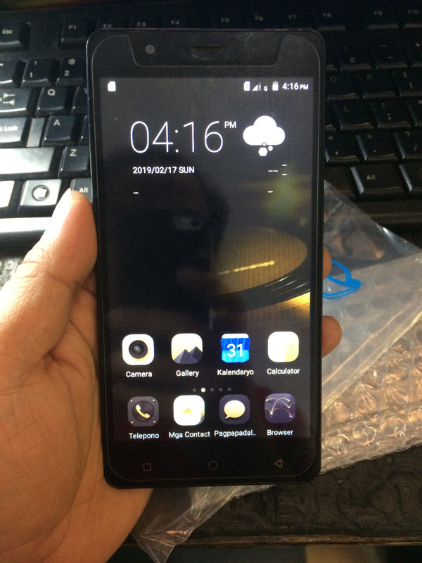

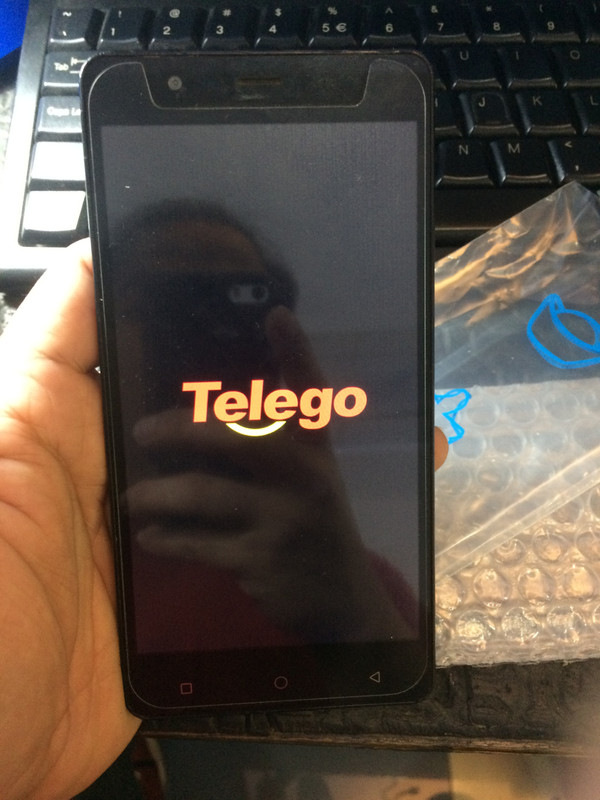

Share ko lang tong gawa ko ngayon mga boss.
Credit dito kay boss K2fOne tested file nya: https://www.antgsm.com/showthread.php?t=146080&highlight=telego+wise
Eto sya nung hang on logo pa

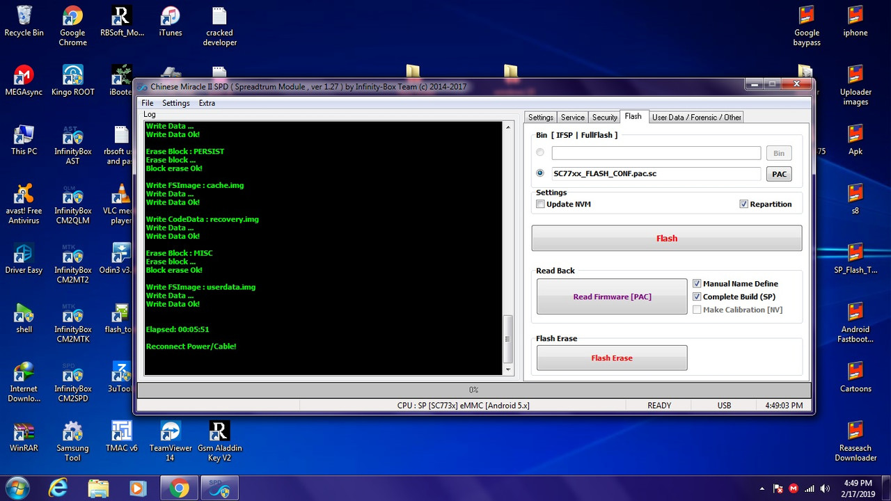

Eto naman logs:
Infinity SC Firmware Detected
FW Size : 1710 MiB
Load Ok!
Operation : Flash [ v1.27 ]
======= Flash
Files set for flashing :
[ MCU ] : SC77xx Infinity Package
1. Remove battery. Insert battery back
2. Press and hold 'VolumeUp' and 'VolumeDown' keys
-> Alternative : just ONE 'VolumeUp' or 'VolumeDown' key
3. Insert cable
==== Wait for phone...
Phone found! [ 21 ]
Port Opened
Sync...
Initial Boot Failed!
Boot not done, reason : Wrong BootKeys
Hint : Reset power and use ANOTHER BootKey ( VOL up or VOL down )
Reconnect Power/Cable!
======= Flash
3. Insert cable
Phone found! [ 21 ]
Port Opened
Sync...
InitBoot Done [ 0x81 ] , Ver : SPRD3
Sync...
Sending FDL
[Info] : If SW freeze here more, than 15 seconds - remove cable
FDL Ready!
Boot Ver : SC773x Android 5.x eMMC v1.0 Inf
Sending FLASH FDL
FLASH FDL Ready!
Boot Ok!
FlashMode Set : Ok!
PMTManager : Load 0x18 records
PMTManager : PMT Update Ok!
Flashing now
Update BootCode : u-boot-spl-16k.bin
Write Data ...
Write Data Ok!
Update BootCode : u-boot.bin
Erase block ...
Block erase Ok!
Write Data ...
Write Data Ok!
Write FSImage : prodnv.img
Write Data ...
Write Data Ok!
Write CodeData : sc7731g_CP0_modem.bin
Write Data ...
Write Data Ok!
Write CodeData : DSP_DM_Gx.bin
Write Data ...
Write Data Ok!
Erase Block : RuntimeData
Erase block ...
Block erase Ok!
Write CodeData : sc8830g_modem_CP2_WCN_14D_W15.38.4_Release.bin
Write Data ...
Write Data Ok!
Write CodeData : logo_540x960.bin
Write Data ...
Write Data Ok!
Write CodeData : fblogo_540x960.bin
Write Data ...
Write Data Ok!
Write CodeData : boot.img
Write Data ...
Write Data Ok!
Write FSImage : system.img
Write Data ...
Write Data Ok!
Erase Block : PERSIST
Erase block ...
Block erase Ok!
Write FSImage : cache.img
Write Data ...
Write Data Ok!
Write CodeData : recovery.img
Write Data ...
Write Data Ok!
Erase Block : MISC
Erase block ...
Block erase Ok!
Write FSImage : userdata.img
Write Data ...
Write Data Ok!
Elapsed: 00:05:51

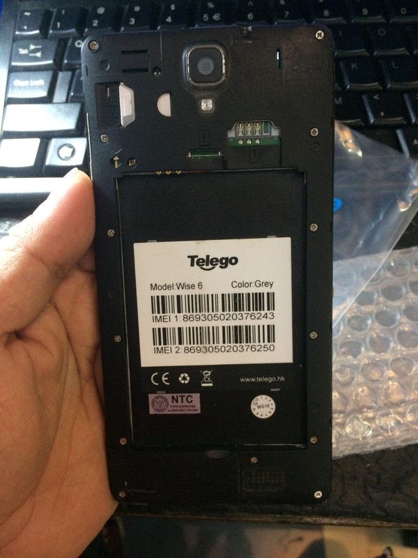

Eto naman exact model:
free photo upload
Done...
