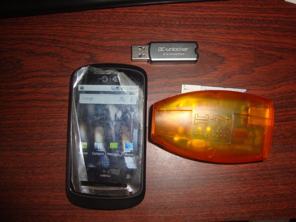

History: 4 locks dahil na ubos yung unlock counter dahil pinaglaroan ng mai-ari
gadget: DC-Unlocker Dongle
procedure:

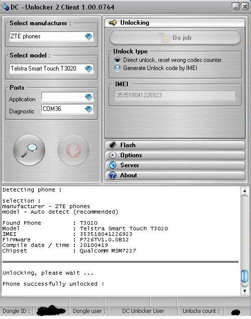

run DC-Unnlocker Dongle
select manufacturer
select model
phone most be in FTM mode
For correct ZTE Racer or ZTE Blade phone detection, turn on phone in FTM mode (press at same time buttons "Vol. -", "End call" and "Power" for at least 5 seconds). Then connect USB cable, wait till windows install drivers and after can detect phone.
click auto search
click unlocking tab
click unlock
wait until done
