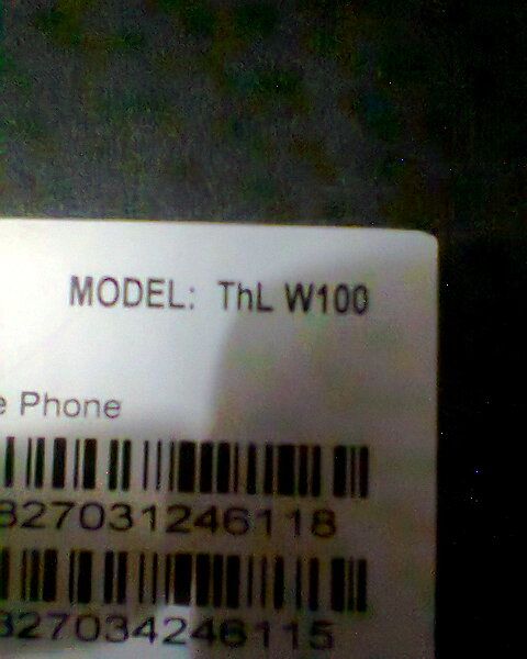

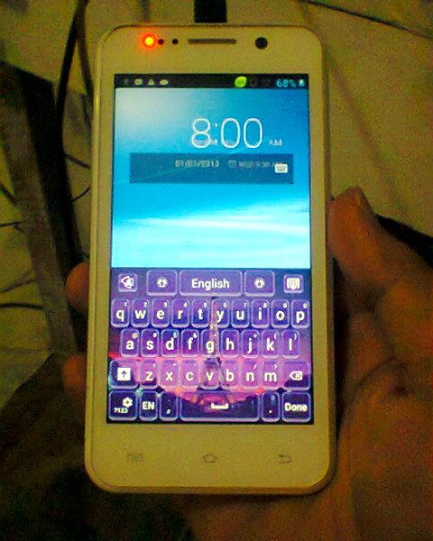

Share ko lang nagawa ko na phone THL W100 late upload kasi medyo Busy.
Problem; Enter Password ,sabi ni customer nakalimutan daw niya
price ako agad sa kanya,buti pumatol sa price..
Hanap ako kung may hard reset pero wala..

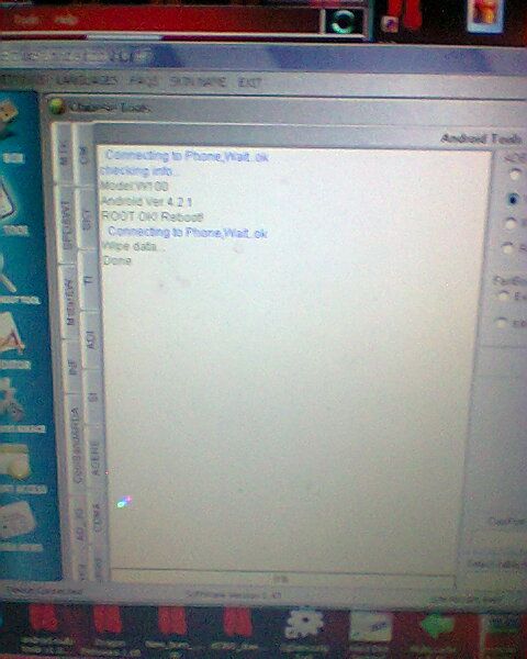

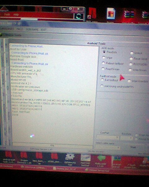

Open piranha,select android tab
first read info,kilangan naka on ang unit
Press read info bago salpak USB.
Second press ADB ROOT

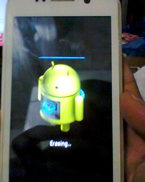

3rd Click wipe data wait mo hanggang mag restart bigla at ito lalabas
and Boom pera na..tnx..:-*
