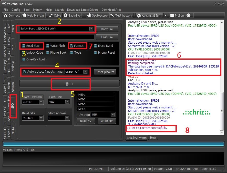

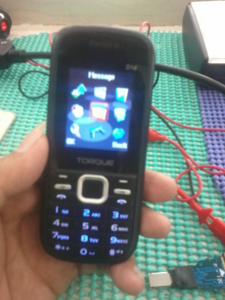

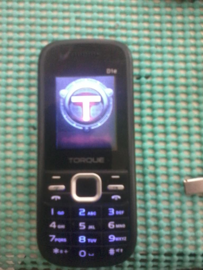

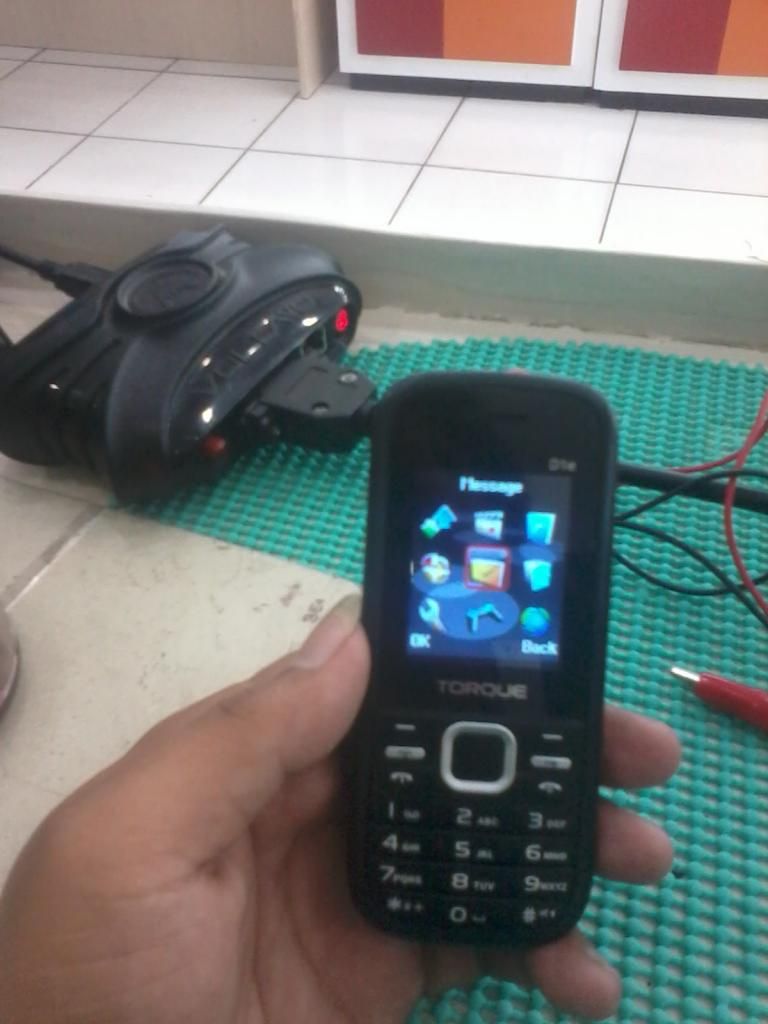

.::chriz::. Expired Account Joined Jun 12, 2014 Messages 162 Reaction score 5 Points 201 Location calamba laguna Aug 16, 2014 #1 share ko lang para din sa newbie.. eto xa hang only sa logo eto steps ginawa ko sundan nyo na lang -Open Volcano and Select SPD Tab -Load Boot File -Tick Read Flash -Select Auto Detect Pinout -Hit Run -Tick Format -Hit Run eto na xa ok na tnx for viewing sana makatulong.. Last edited by a moderator: Aug 21, 2019
