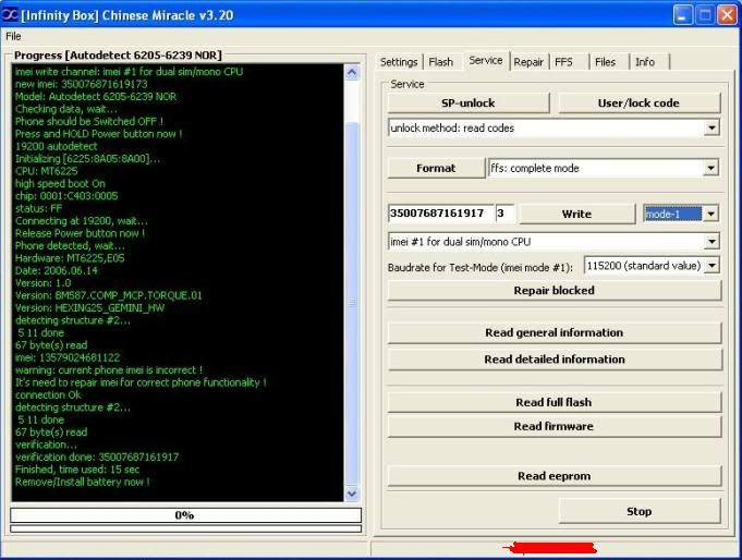

torque d90,hang at start-up,nag o-on pero wala po mapindot na keypad....done via format by infinity with the help of padfinder.....

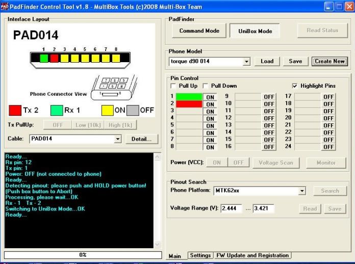

-open padfinder sw
-detect pinout of phone
-open infinity sw

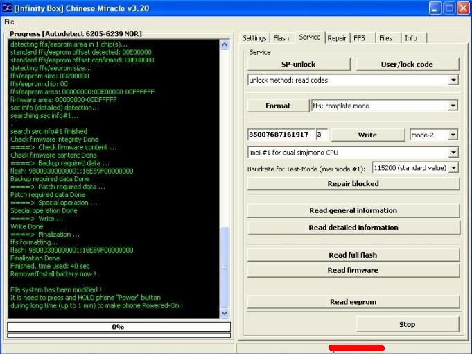

-select chinese miracle
-select format "ffs:complte mode"
-then rebuild imei
-done
pinout
logs po ng format
then rebuild po ung imei
