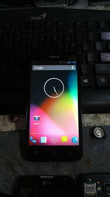

how to hard reset TORQUE MOTION
off the phone
press volume up + power button
release mo pag lumabas na ang logo ng TORQUE
hintayin uli pag lumabas ang android roboot tapos press uli ang power
lalabas ang android recovery
select wipe data/factory reset
select yes--delete all user data
select reboot system hintayin lang mag reboot ang phone
boom done na po yan....
