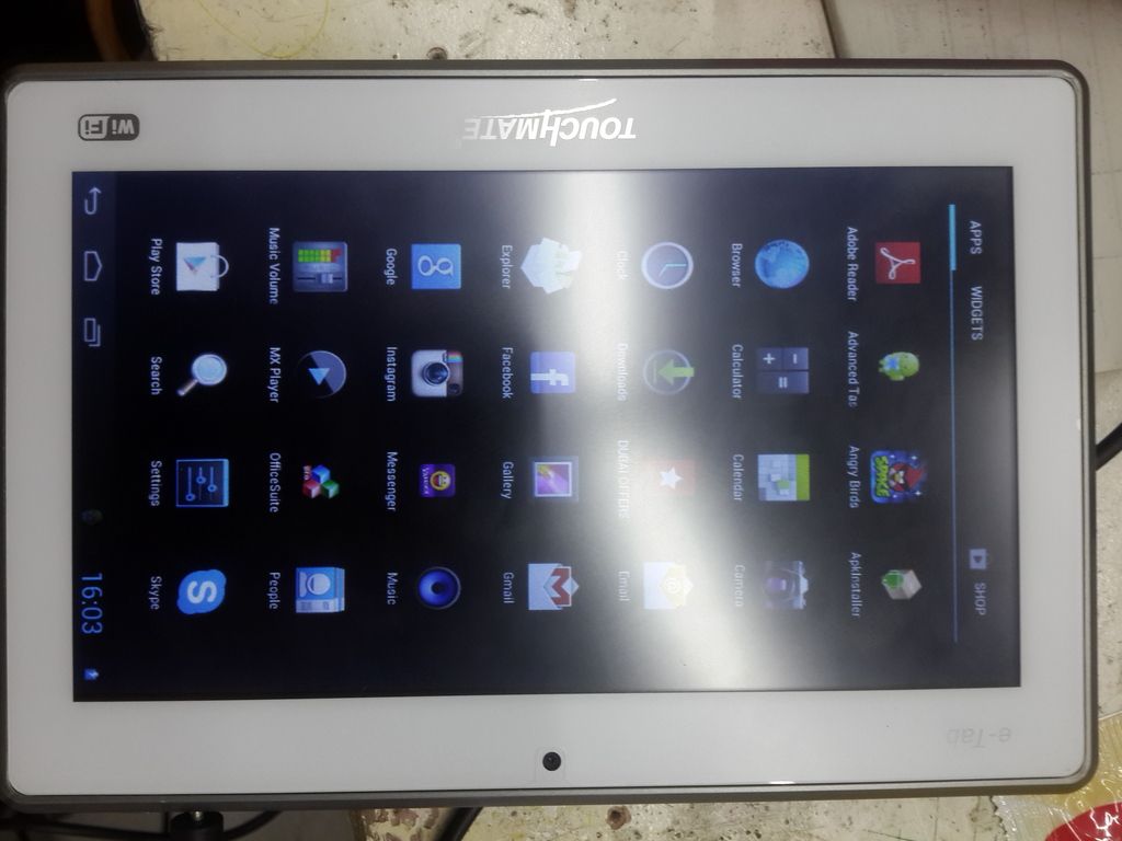

HISTORY: Tulala sa Logo.
Try ko Hard Reset Using Volume UP + Power Ayaw
Try ko RKTOOLS Natapos Ayun Patay na.
Try ko hanap Firmware.
PASOK DITO
Sundan lang po ito.
After madownload ang firmware heto naman ang flashtool RKBATCHTOOL
PROCEDURE:
Run the RKBatchTool
* Add flash file to the FW Path
* Connect your Tab into flash mode (power+volume up)
* If your tab connected correctly it will show in the flash tool
* Last press upgrade
DONE!
