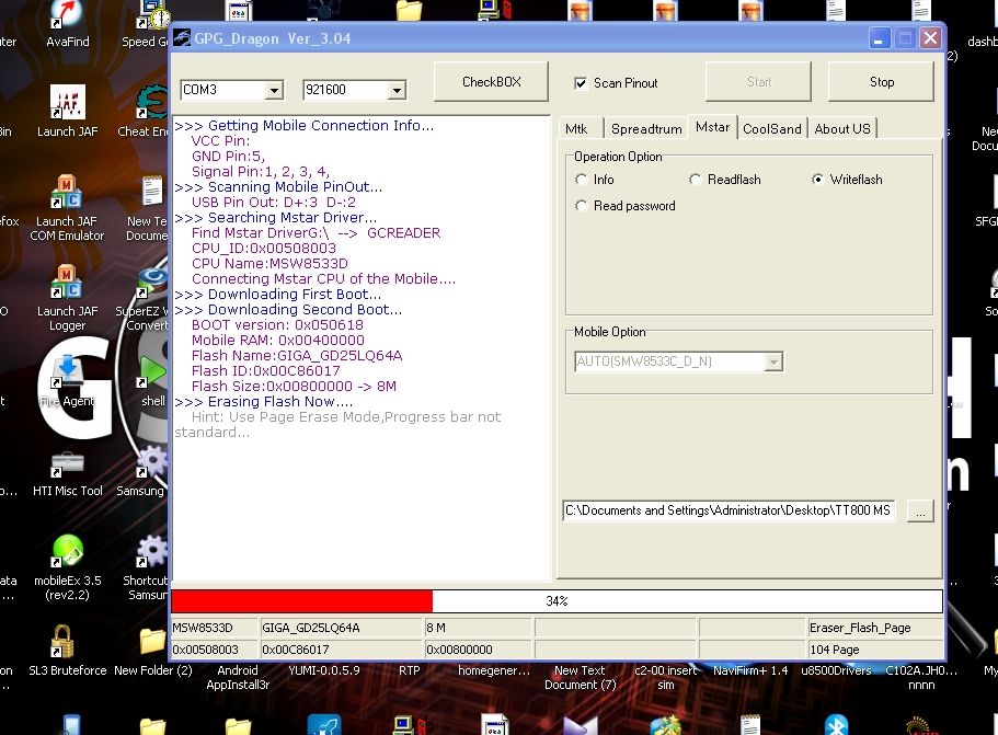

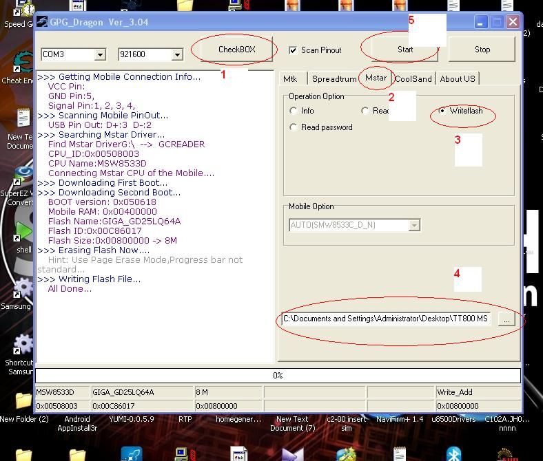

PROCEDURE:
1.Connect GPG to PC
2.Open GPG software GUI for me i use GPGDragon_Ver3.04.exe.
3.Click Check TAB to detect port.
4. Now follow this SS.
Hang LOGO
TOOLS:
1.PC
2.GPGDragon w/ P-05B
3.TT800 FIRMWARE TESTED MSTAR
4.MSTAR USB DRIVER
PROCEDURE:
1.Connect GPG to PC
