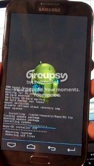

1st put into Download Mode

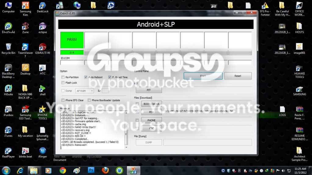

Open odin and click PDA thin Select file ROOTING FILE thin click START
LOGS
Code:
<ID:0/065> Added!!
<ID:0/065> Removed!!
<ID:0/023> Added!!
<ID:0/023> Odin v.3 engine (ID:23)..
<ID:0/023> File analysis..
<ID:0/023> SetupConnection..
<ID:0/023> Initialzation..
<ID:0/023> Get PIT for mapping..
<ID:0/023> Firmware update start..
<ID:0/023> cache.img
<ID:0/023> NAND Write Start!!
<ID:0/023> recovery.img
<ID:0/023> RQT_CLOSE !!
<ID:0/023> RES OK !!
<ID:0/023> Completed..
<OSM> All threads completed. (succeed 1 / failed 0)
<ID:0/023> Removed!!
