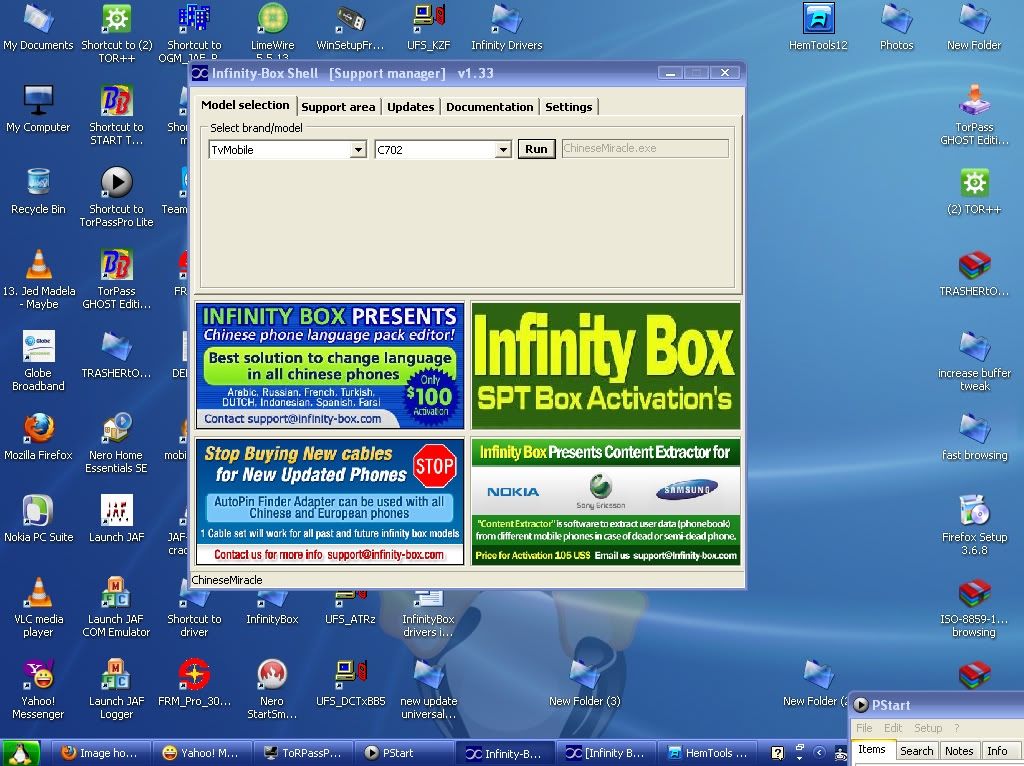

mga boss share ko lang tv mobile c100 input phone lock code.
open infinity shell
choose tv mobile
choose c702 then click run
read full flash ko muna bago ko finormat hindi kc mread un codes eh.

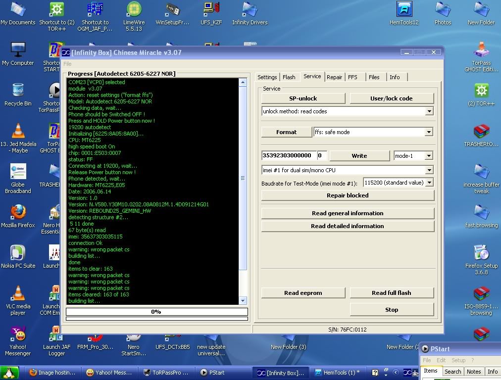

eto un logs
COM23 [VCP0] selected
module v3.07
Action: reset settings ("format ffs")
Model: Autodetect 6205-6227 NOR
Checking data, wait...
Phone should be Switched OFF !
Press and HOLD Power button now !
19200 autodetect
Initializing [6225:8A05:8A00]...
CPU: MT6225
high speed boot On
chip: 0001:E503:0007
status: FF
Connecting at 19200, wait...
Release Power button now !
Phone detected, wait...
Hardware: MT6225,E05
Date: 2006.06.14
Version: 1.0
Version: N.V580.Y30M10.0202.08A0812M.1.4D091214G01
Version: REBOUND25_GEMINI_HW
detecting structure #2...
5 11 done
67 byte(s) read
imei: 35637303035115
connection Ok
warning: wrong packet cs
building list...
done
items to clear: 163
items cleared: 163 of 163
building list...
done
items remains: 2
Finished, time used: 28 sec
Remove/Install battery now !

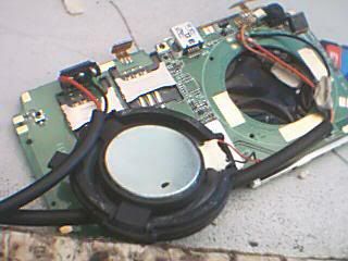

eto nmn ang pin out

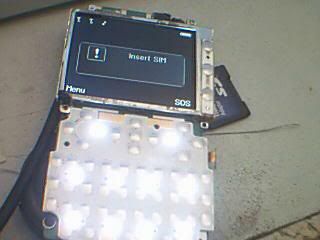

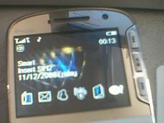

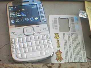

at eto n po ang unit
humataw na naman ang infinity ko
