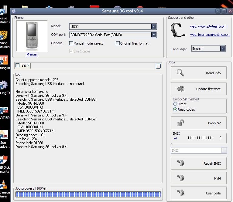

CUSTOMER PROBLEM
U800 PHONE LOCK
ITO YUNG PICTURE
procedure
kunin ang z3x box
iligay po yung cable pang z3x e210+
read info
ITO NA YUNG REDING NG Z3XBOX
IPASUK ANG SIM SA PHONE LALABAS YONG CODE
MAKIKITA MO YONG CODE PAG NA READ CODES MO
PAGKATAPOS LALABAS YUNG CODES NA NILAGAY
PAGKATAPOS PASOK MO NA AGAD OK NA YON.

U800 PHONE LOCK
ITO YUNG PICTURE
procedure
kunin ang z3x box
read info
