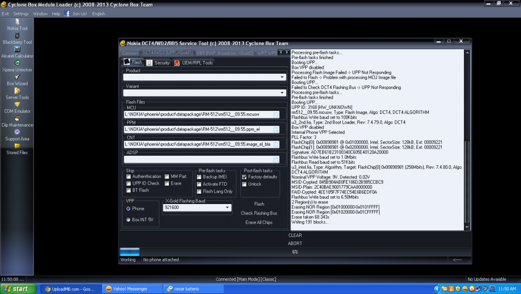

flash po unit sa cyclone using easy cable..
2330 rm512 eto po flashfile,v 9.55 http://www.sendspace.com/file/1xrp03
hintayin lng matapos
tapos na i flash..

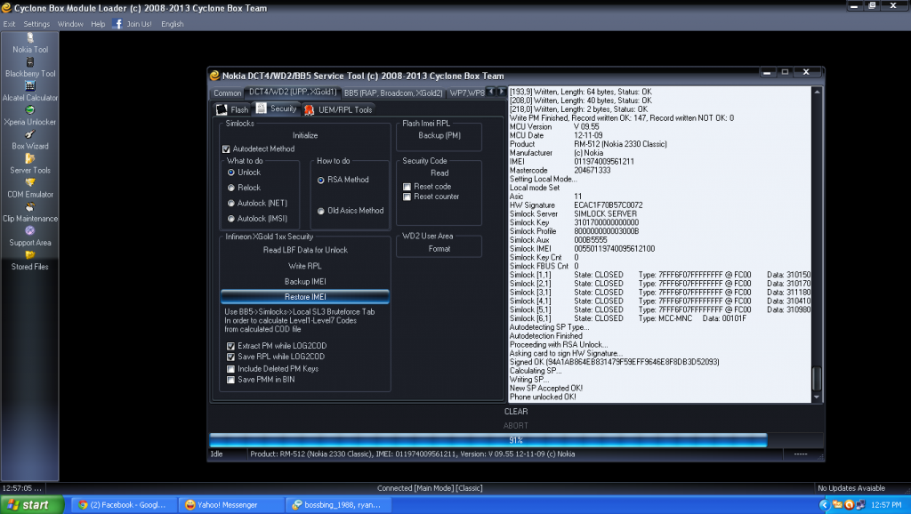

write pm napo, eto po pm files piliin lang po jan ung 2330c,, http://www.4shared.com/get/phqmOnBs/...760h_by_m.html
pagkatapos i write pm unlock nyo napo..

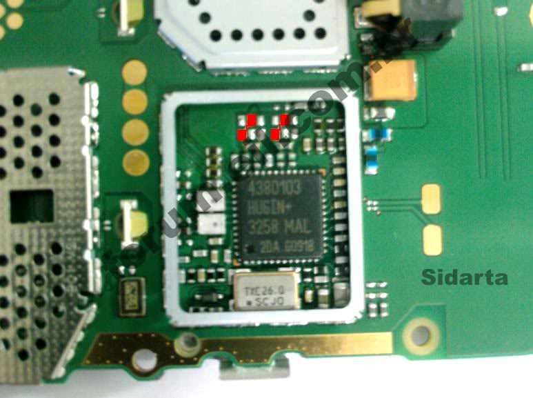

baklasin napo unit for converting or para tangalin ung 2 filters at i jumper po ng ganito..

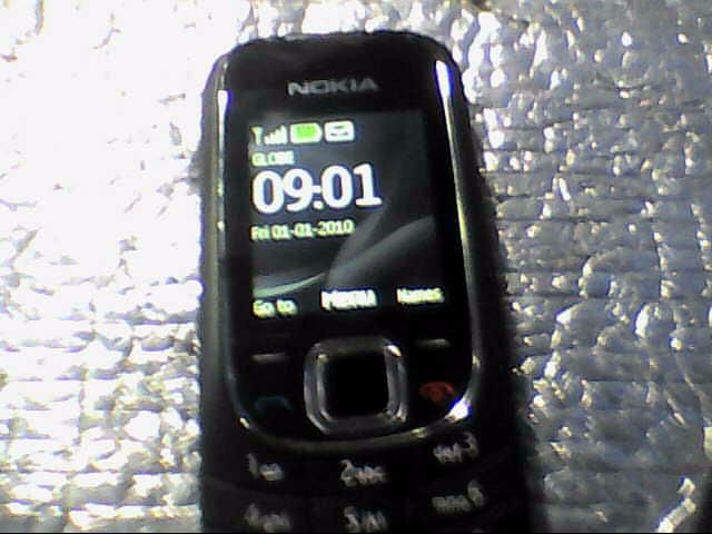

pagkatapos buin na unit at eto napo lakas ng signal..
