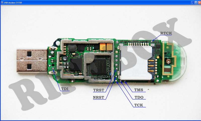

Procedure

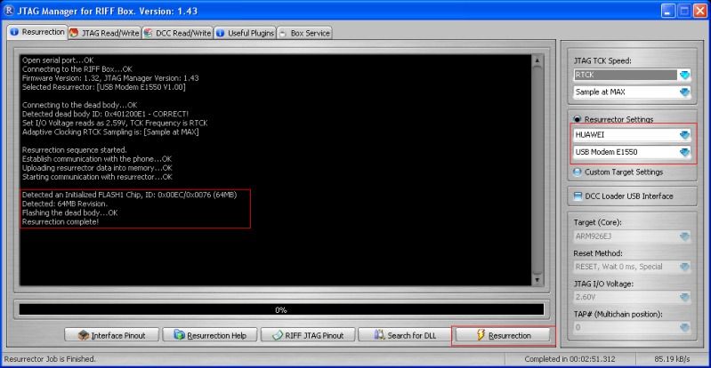

1st attemp
1.Select E1550
2.Solder wire
3.Resurrect
4.testing no luck

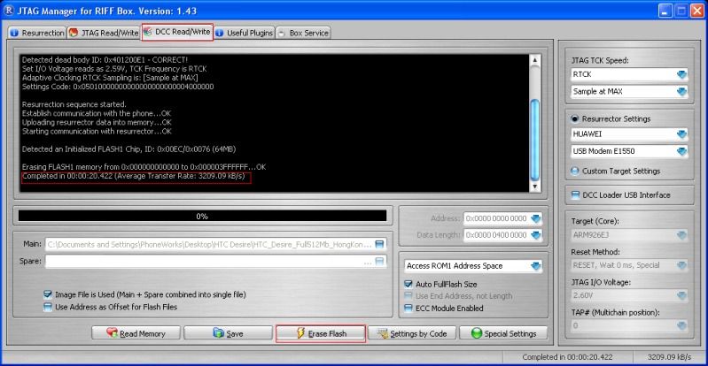

2nd Attemp
1.Select E1550
2.Solder Wire
3.Erase FULL NAND/NOR Memory

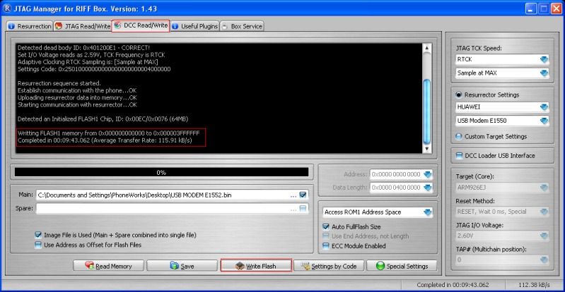

4.Write Full Image into NAND Memory
5.Resurrect
Done

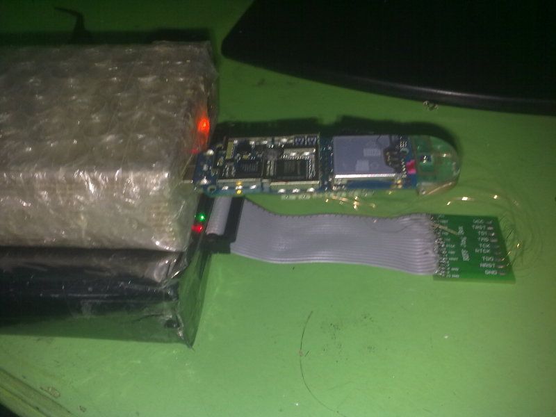

Screen Shot:
ACTUAL PIC
PINOUT
ERASE
WRITE
RESURRECT

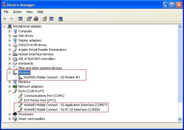

Device manager

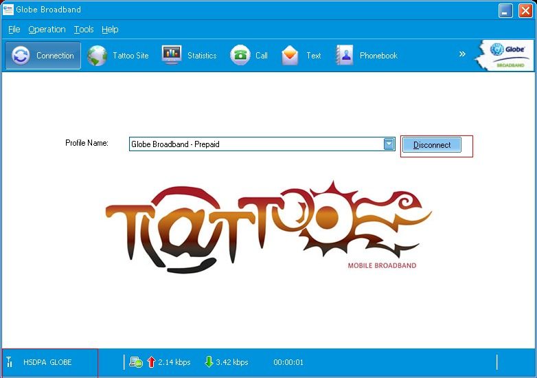

Globe BroadBand
Note:
Set up nyo nalang po yung network TYPE at BAND at pwede kana mag net
