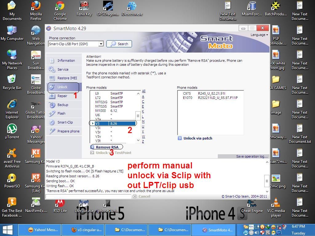

V3 moto v8.26 xcingular unlock done
v3 v8.26 xcingular may natira pa.. unlock done
procedure:
open Smart moto
connect LPT/clip usb to sclip and connect v3 usb to sclip usb hub/add supply 9-12v power to sclip/ power on the phone before start the operation
click search for info info
click unlock tab
select correct model
click remove RSA wait untill done
remove LPT/clip usb/remove power supply and insert again.. dont remove v3 USB in sclip
manual unlock in sclip
press unlock button in sclip box wait untill the LED light blink and becomes green.
Screenshot:
Click here to view the original image of 769x577px.

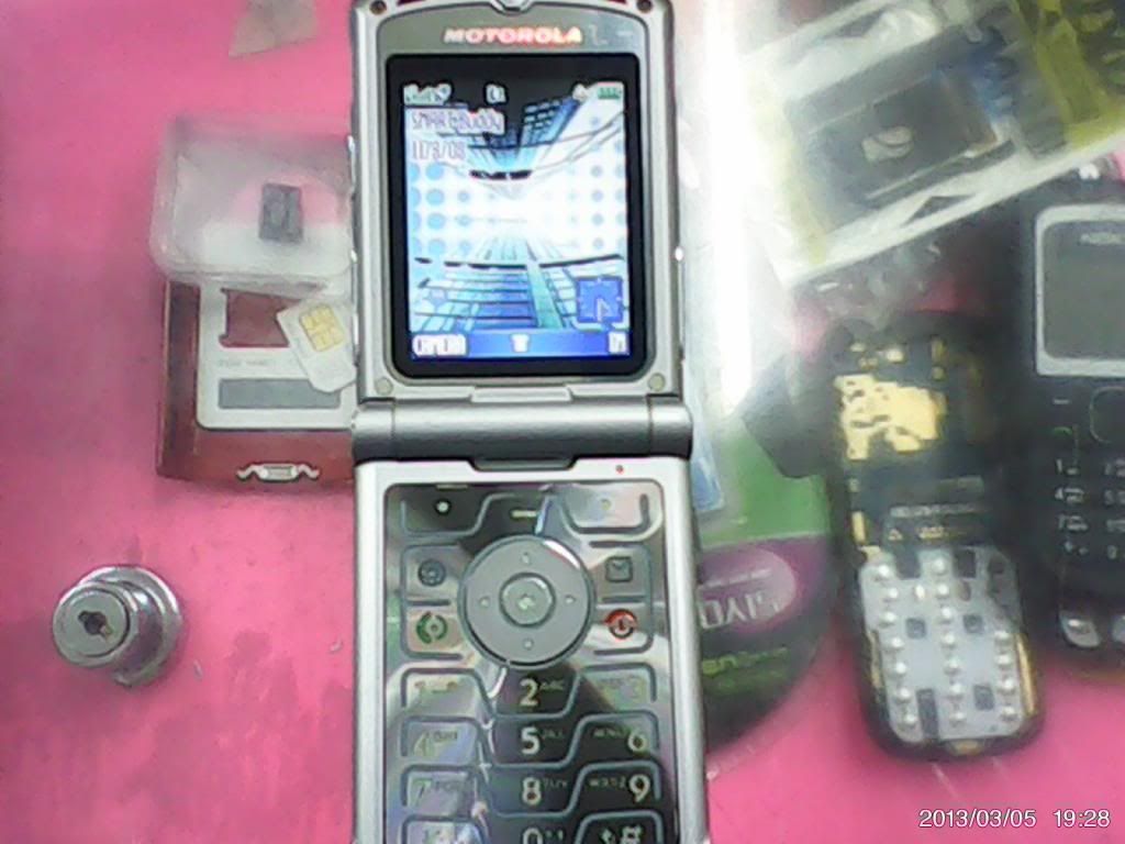

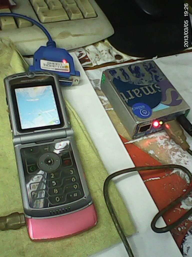

finish:
Click here to view the original image of 768x1024px.
procedure:
open Smart moto
click unlock tab
Screenshot:
finish:
