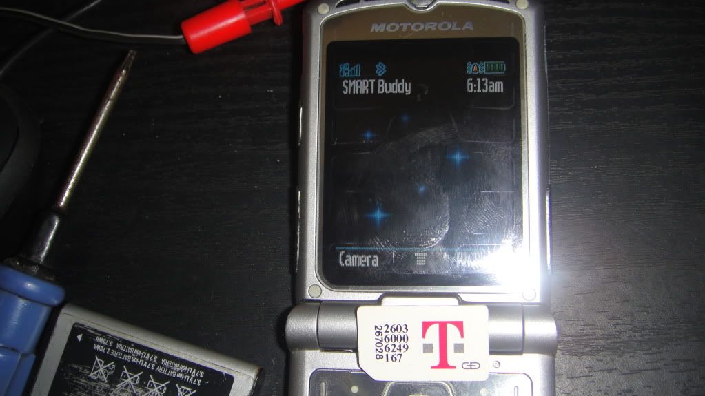

boss share ko lng to tangap ko ngaun,,,, v3r naka lock sa t-mobile done. via testpoint.

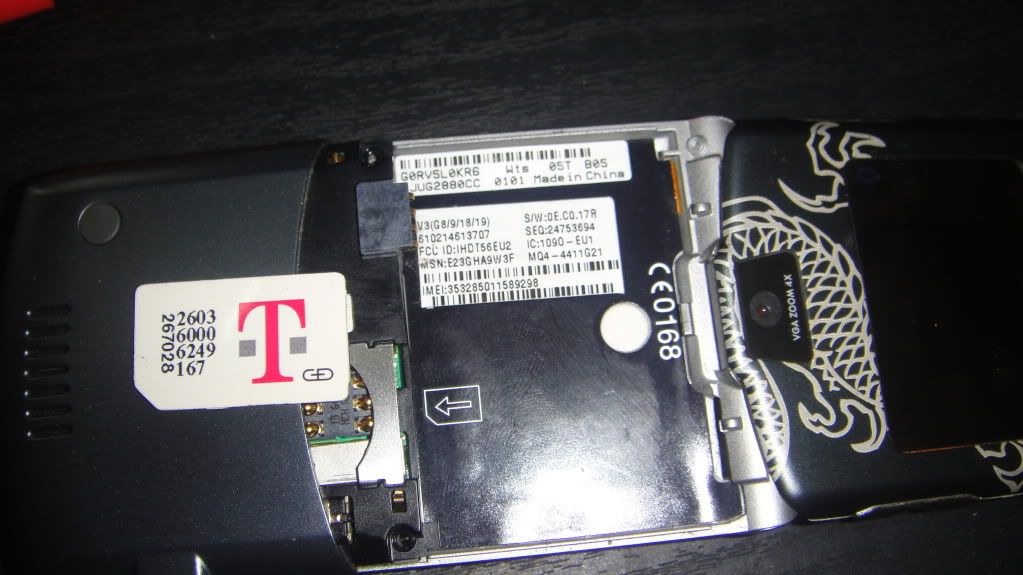

ITO PO CYA PIC BEFORE UNLOCK
1 open smart clip

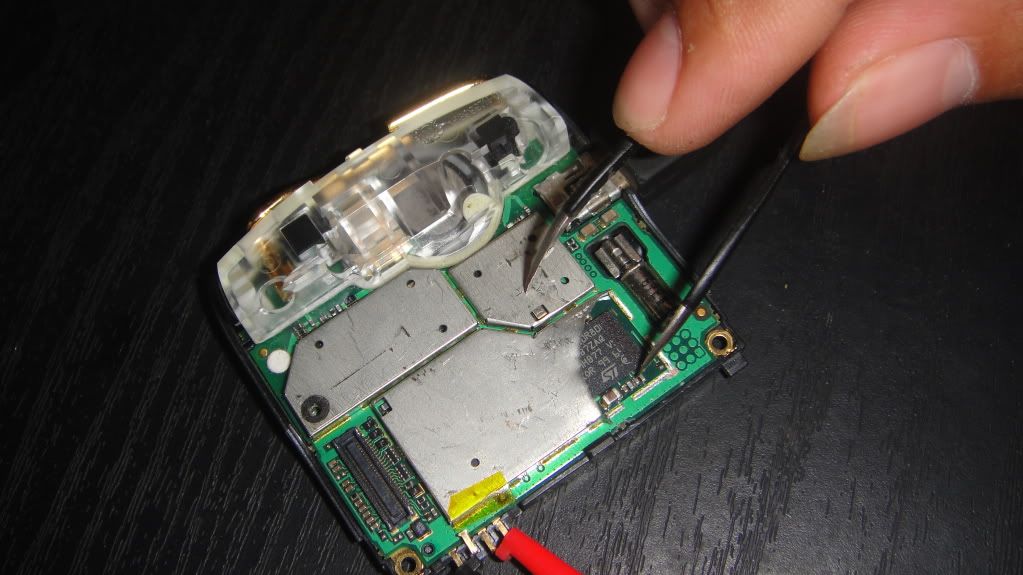

2 ready to testpoint..........
Tools:
Twister pangTP
V3 USB Cable
Power Supply
Procedures:
1. Kalasin ang Phone
2. Kabit neg at positive sa phone galing sa power supply
3. Connect USB
4. Open P2k Tool 3.9
5. Connect TP

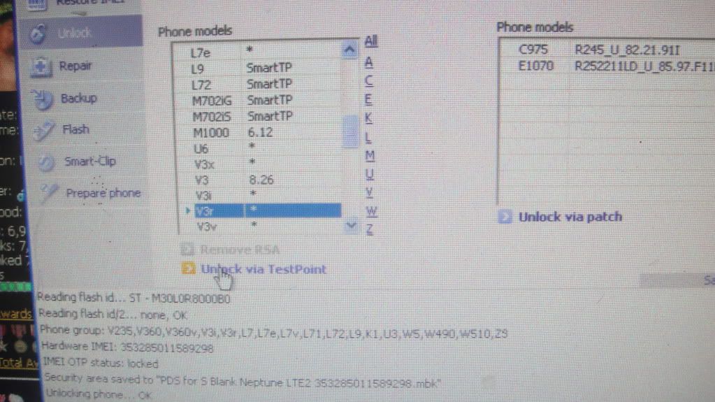

6. I-on ang Power Supply sabay pindot ng Do Selected Jobs
ITO PO YUNG ACTUAL...
ITO IN PO YUNG SCREEN SHOT...

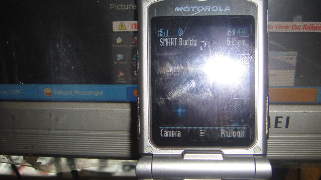

ITO NA PO CYA DONE NA........
