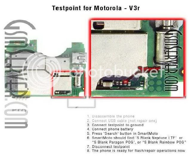

V3r unlocked by free SW via TP
nag dagsaan na mga unit galing sa labas dito sana tuloy tuloy na eto
v3r lock from Tmobile unlocked mstool crack hirap talaga pag walang box
buti nalang at kuhang kuha ko na ang kiliti sa tp
isang click lang swakkk kaagad!
v3r tp
unlocking connect tp
ayus!

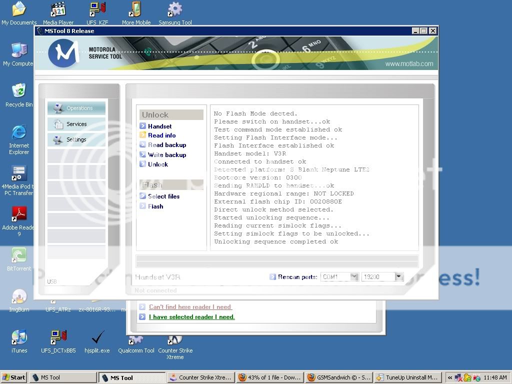

Flash Interface established ok
Handset model: V3R
Connected to handset ok
Detected platform: S Blank Neptune LTE2
Bootcore version: 0300
Sending RAMDLD to handset...ok
Hardware regional range: NOT LOCKED
External flash chip ID: 0020880E
Direct unlock method selected.
Started unlocking sequence...
Reading current simlock flags...
Setting simlock flags to be unlocked...
Unlocking sequence completed ok

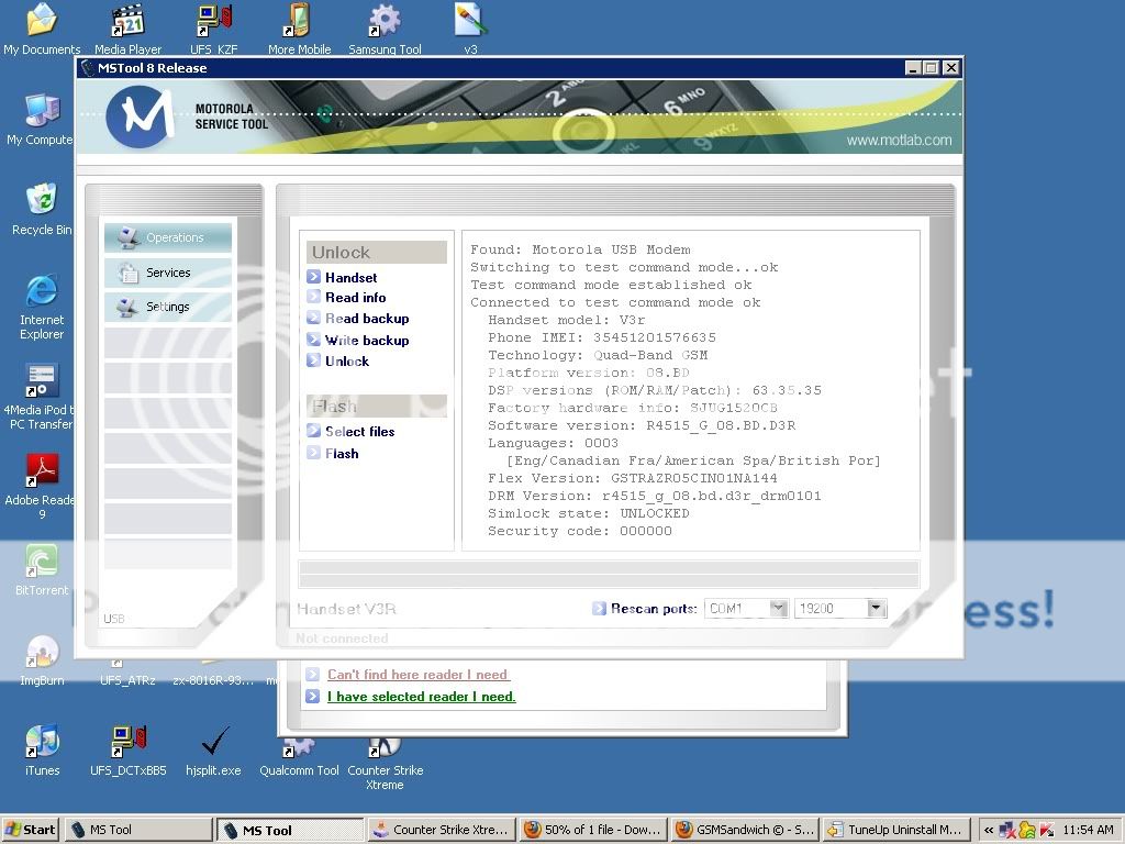

Found: Motorola USB Modem
Switching to test command mode...ok
Test command mode established ok
Connected to test command mode ok
  Handset model: V3r
  Phone IMEI: 35451201576635
  Technology: Quad-Band GSM
  Platform version: 08.BD
  DSP versions (ROM/RAM/Patch): 63.35.35
  Factory hardware info: SJUG1520CB
  Software version: R4515_G_08.BD.D3R
  Languages: 0003
    [Eng/Canadian Fra/American Spa/British Por]
  Flex Version: GSTRAZR05CIN01NA144
  DRM Version: r4515_g_08.bd.d3r_drm0101
  Simlock state: UNLOCKED
  Security code: 000000
  User code: 1234
Handset info read ok

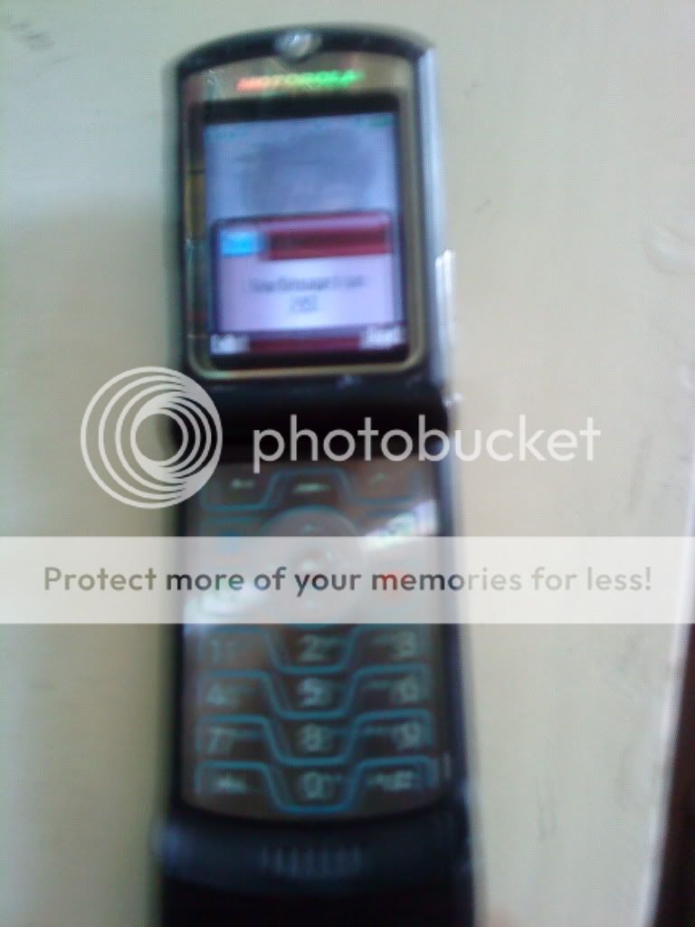

yahooooooooooo =))
eto na po unlocked na
