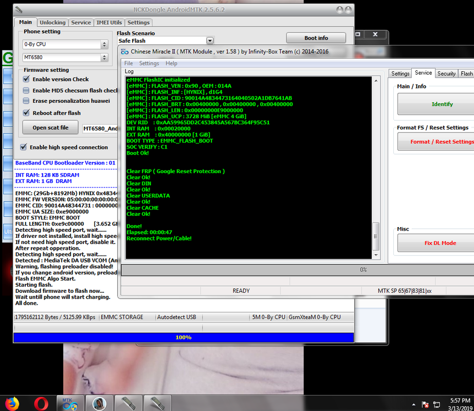

dahil wala ako makita firmware my post ako Vinovo L3 error pass nawla na sa list file ko ang firmware eto na my solution na modified firmware Old tricks
una read sa cm2mtk ang info at eto llabas sa vinovo l3
Brand : L3
ProdName : L3
ProdModel : L3
Device : L3
AndroidVer: 6.0
MTKxCPU : MT6580
MTKxPRJ : alps-mp-m0.mp1-V2.34_droi6580.weg.m_P29
MODEM :
BaseBand : MT6580_S00_MOLY_WR8_W1449_MD_WG_MP_V57_P6_1_wg_n
ngaun copy nyo MTKxPRJ ETO alps-mp-m0.mp1-V2.34_droi6580.weg.m_P29

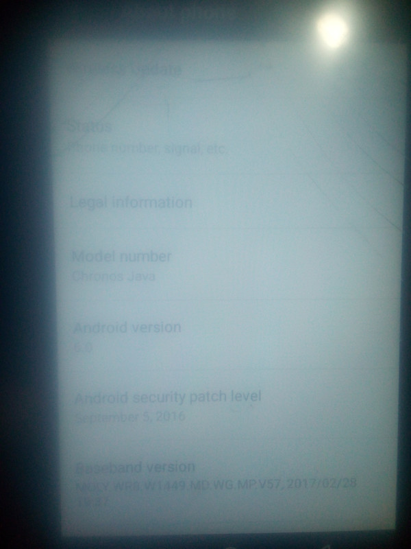

at paste sa firmware file ko at si skk chronos Java lumabas flash ko sa nck crack system only done
flash system Only nck crack after flash format use cm2mtk
eto
done yan...
