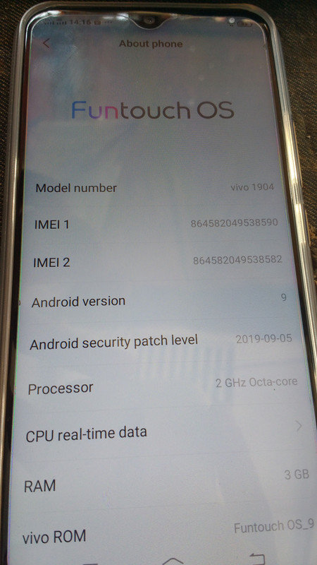

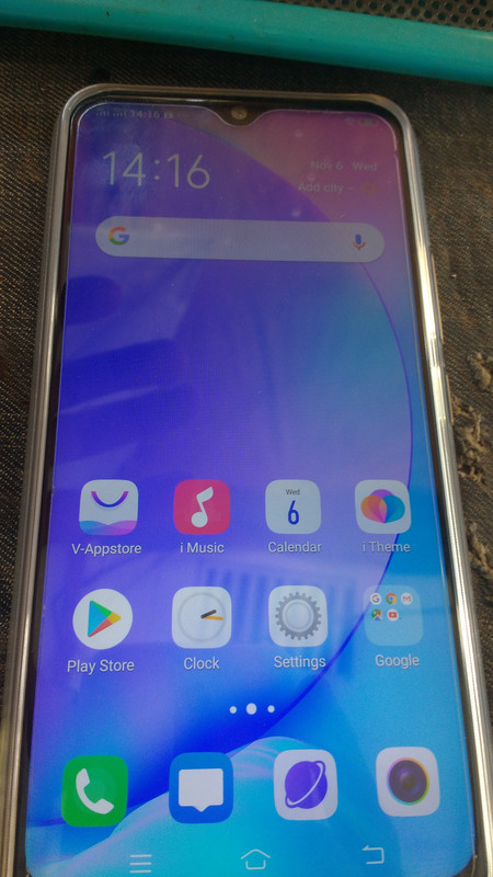

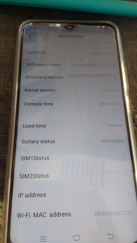

vivi 1904 password and frp done sa crack

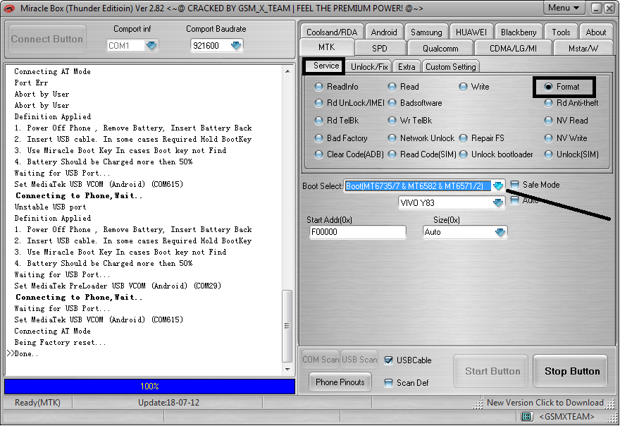

procedure:
open Miracle Thunder 2.82 Crack
dahil mtk ang unit click mtk
service , format , bootMT6735/7 & MT6582 & MT6572/2
click vivo Y83 piliin mo sa gilid ng boot my naka lagay safe mode and outo my roon pa sa baba nito yung ang e chick mo
click start button dahil mtk yan matik na yung driver hantayin mo lang mag done
ito log's
ito picture: ng crack

procedure:
ito log's
Code:
1. Power Off Phone , Remove Battery, Insert Battery Back
2. Insert USB cable. In some cases Required Hold BootKey
3. Use Miracle Boot Key In cases Boot key not Find
4. Battery Should be Charged more then 50%
Waiting for USB Port...
Set MediaTek USB VCOM (Android) (COM615)
Connecting to Phone,Wait..
Unstable USB port
Definition Applied
Set MediaTek PreLoader USB VCOM (Android) (COM29)
Connecting AT Mode

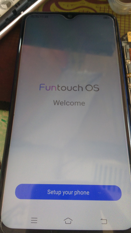

Being Factory reset...
>>Done..
my frp pag katapos pero yung sakin wala kilala ko kc si tumer alam nia google account nia
