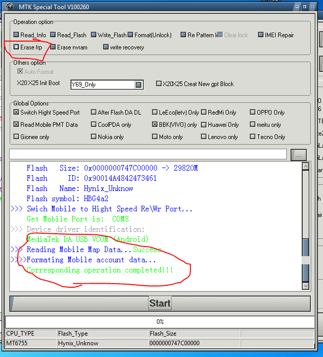

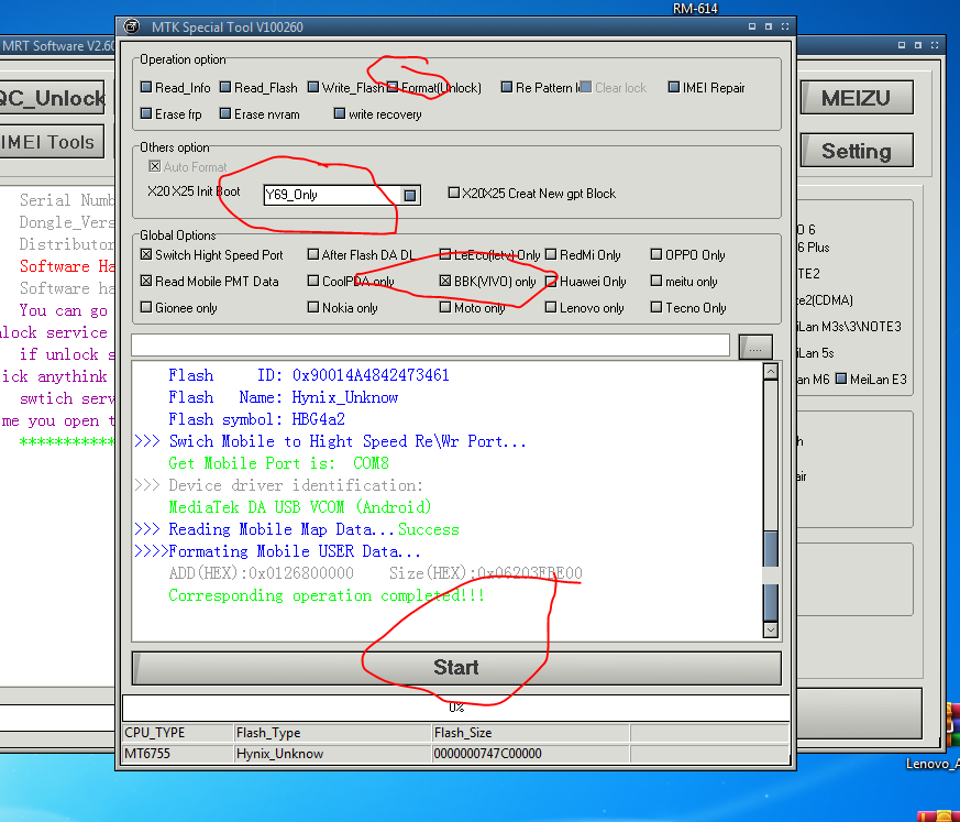

open mrt software
choose mtk
follow pic
then hold volume up and down to boot insert usb
SCREENSHOTS

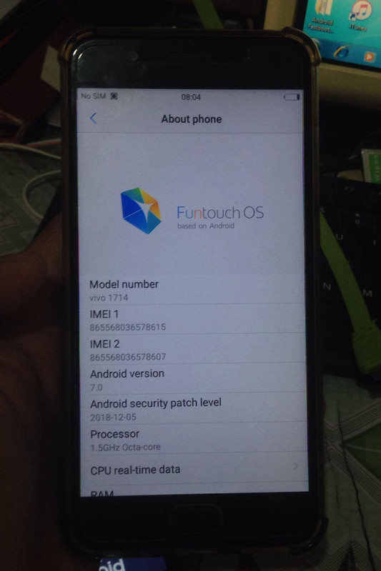

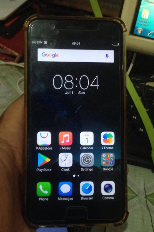

done wla na password
pero may frp google account
