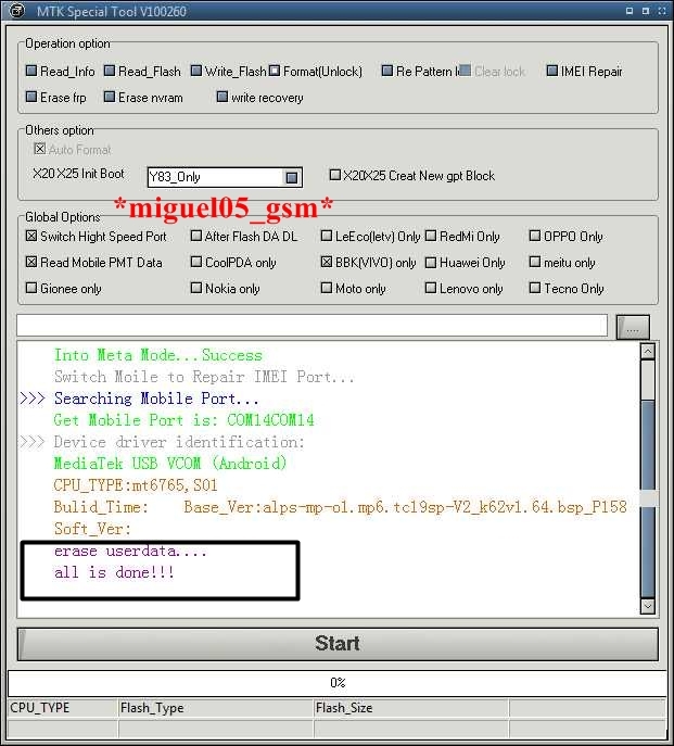

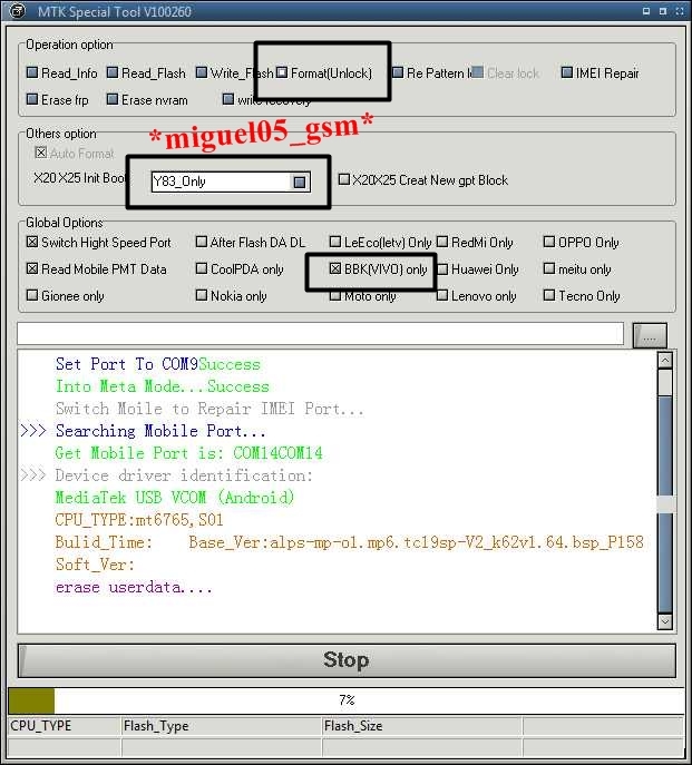

Procedure:
open mrt 2.60
run mtk special tool
select BBK(vivo)only
select model y83
saksak phone naka normal mode
click format(unlock)
now power off ang phone and wait hanggang mag connect
done...:D
