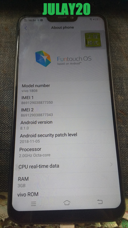

VIVO 1808 8.1.0 Password and Frp Done

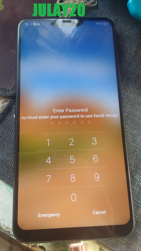

pinag laroan ng bata kaya ayaw na ma open di alam ni mam kong ano na yung password kc pnindotpindot daw ng bata nya

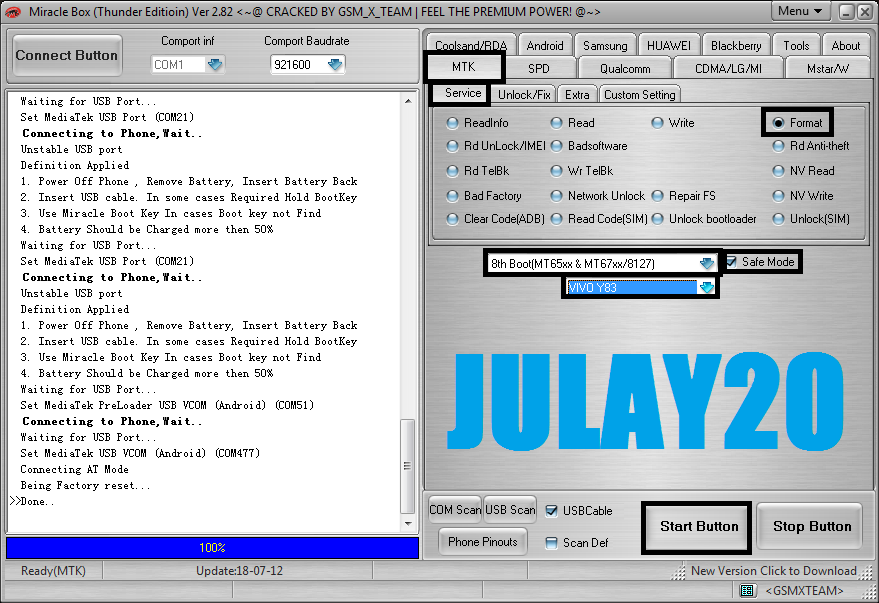

TOOL Miracle Thunder Crack
Procedure:
open Miracle Thunder
Click MTK
Select Service
Click Format
Select Boot 8th MT65xx & MT67xx/8127
Click Safe Mode
Select VIVO Y83
HIT START BUTTON
Saksak USB Hold voll up antayin mo lang mag done

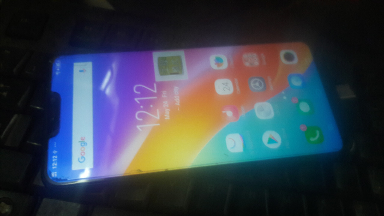

Done ito picture:
ok na pero my isa pa merong FRP o GOOGLE ACCOUNT

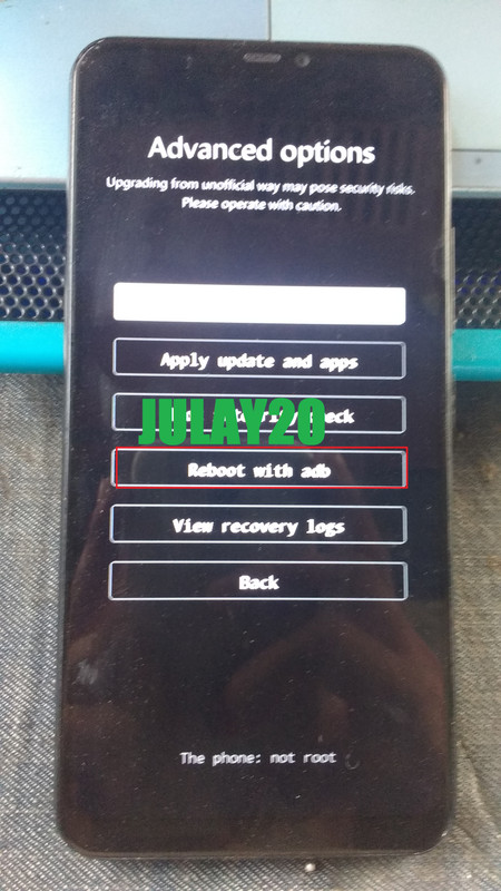

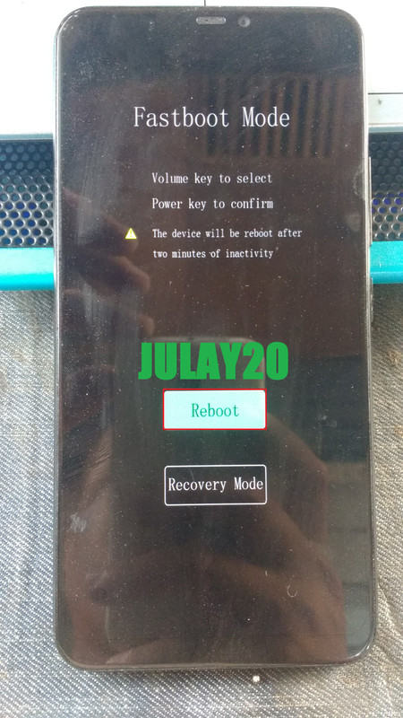

Press power button and voll up

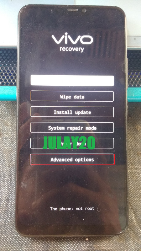

lalabas to
piliin mo yung RECOVERY MODE us voll down and power button
lalabas naman yung RECOVERY
Us voll down piliin mo yung Advanced options
Lalabas naman yung Advanced options
Us Voll down piliin mo yung Reboot With adb mag rereboot ang unit hayaan mo lang

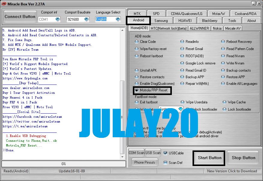

Open Miracle Crack
Select Andriod
Click Motorola FRP Reset
HIT START BUTTON
SAKSAK USB HOLD VOLL UP

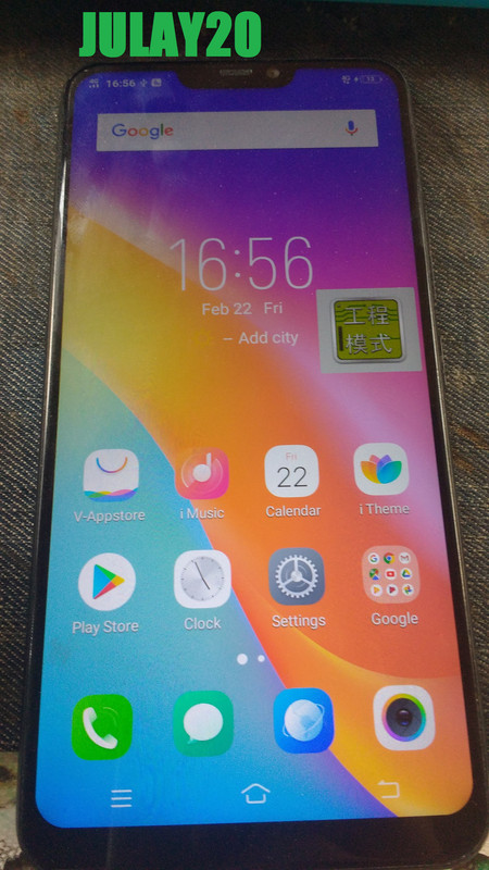

Picture:

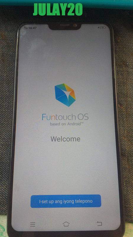

ito na sya done na

LOG's
Code:
Definition Applied
1. Power Off Phone , Remove Battery, Insert Battery Back
2. Insert USB cable. In some cases Required Hold BootKey
3. Use Miracle Boot Key In cases Boot key not Find
4. Battery Should be Charged more then 50%
Waiting for USB Port...
Set MediaTek PreLoader USB VCOM (Android) (COM51)
Connecting to Phone,Wait..
Set MediaTek USB VCOM (Android) (COM477)
Connecting AT Mode
Being Factory reset...
>>Done..
lalabas to
Open Miracle Crack
Select Andriod
HIT START BUTTON
Picture:
ito na sya done na
