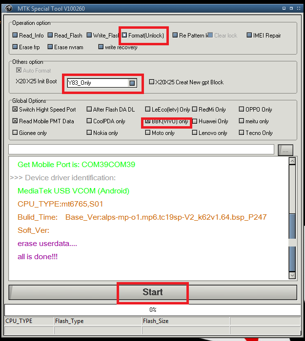

open mrt mtk module....pasundan sa pics mga sir
off unit...salpak mo lng sir auto ditect mtk drivers....

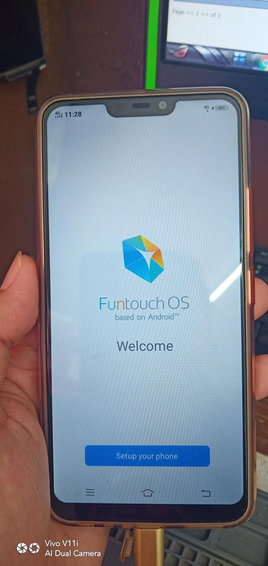

success format frp naman po...

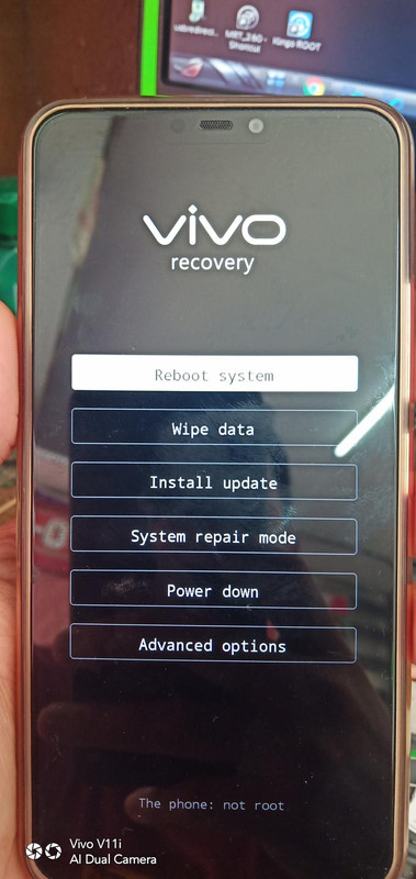

pasok ka xa recovery hold volume up power..
Choose Recovery Mode....
Choose Advanced Options....
Choose Reboot With ADB....

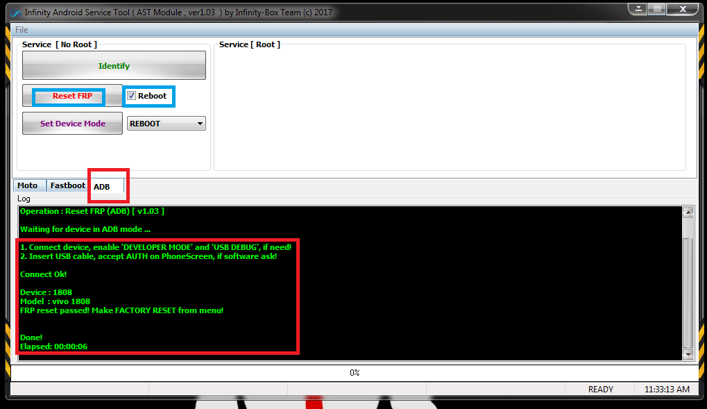

open cm2 ast tool or miracle crack anq qinamit ko cm2 pra swabe sa frp wla nq setup setup direcho na agad sa menu after magreboot ang vivo mo
check mo yung reboot pra dkna mag taka....

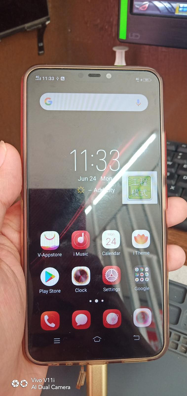

success again...
